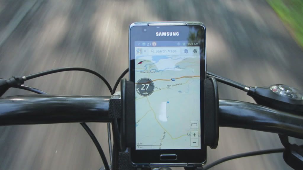

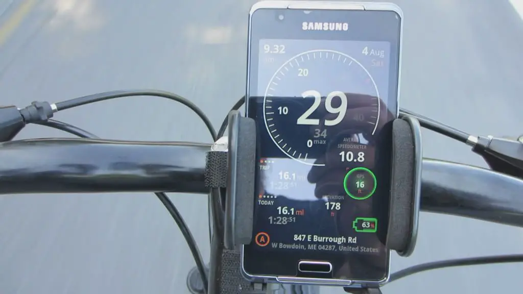

    It's possible that considering all the potential features & functions, upgrading your phone may prove to be the "cheapest" solution overall... I've been using the 'Ulysse Speedometer' https://play.google.com/store/apps/details?id=com.binarytoys.speedometer for a few thousand miles now & I've gotta say it's a good app for the money, even the free version is quite good (there's very little difference between the two).
    I very much like it's overlay option - enabling you to utilize GPS Google Maps (also free) or any other app (music or w/e) while still seeing the speed readout, some "in flight" examples;

    Those are nice shots!
    I am envious... If I do get a chance to upgrade my phone (sometime in the near future), I will definitely use that option.
    I especially like that it is a large screen and clearly visible.
    Thanx again!
