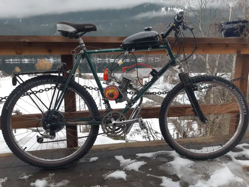

Just had that happen the other day, luckily I carry the tools I need to disassemble the whole bike, Like yourself still breaking it in maybe two tanks so far, same carb, ,gas was running thru and out the filter , I pulled the bottom off the carb checked for grit made sure the float valve was moving and put it together. So far so good I have a feeling this is going to be an issue they are just simple little engines
