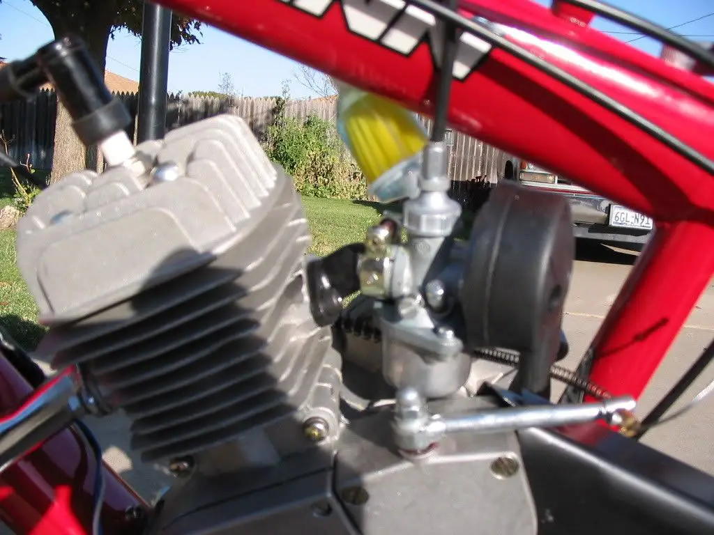

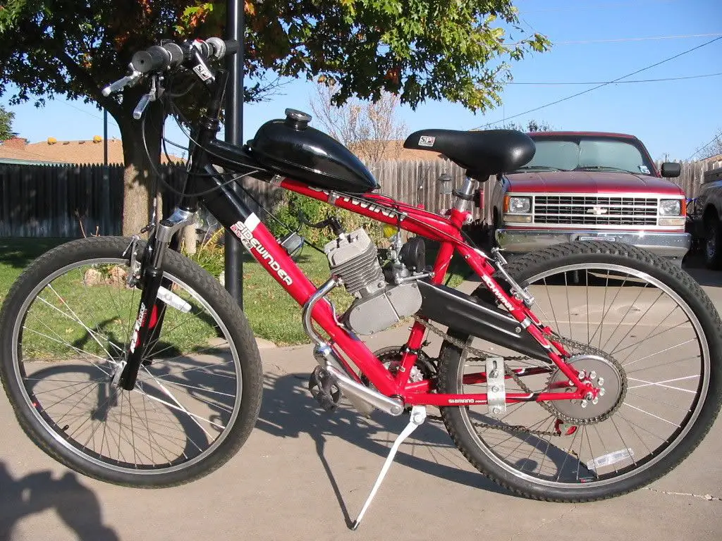

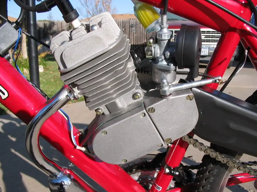

well i had an issues with my bike when i mounted the motor to it this weekend . i bought a brand new schwinn creek. its had a nice back bone the flowed nice with the gas tank on it.. but the down side was the crab would not fit at all. so after about 6 hrs of trying to make and think of making a new intake my 9yr old sone was playing with a 3/4 heater hose and then it came to me...so i put the heater hose on the intake and added a 3/4 in peice of pipe so the carb would bolt to it and BOOM it look,fit and RUNS GREAT...
ill upload a pic of the bike and crab when i get home...
