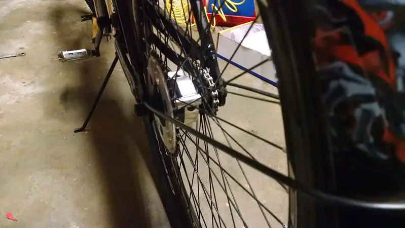

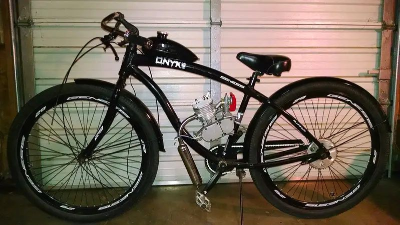

Tonight I took my brother's Sportsman Flyer 'broken' hub sprocket adapter and tested it on my rear hub. It definitely does not fit the 1.50" hub. I know they say 1.52", but I just wanted to make sure. Looks like the bolts bottom out before they completely tighten onto the hub. I can spin it with ease.
Darn...because I was going to chase the threads on the sprocket studs and fix it for myself!![]()
Now I have to decide if I want to go with the gasbike 1.50" hub adapter http://www.gasbike.net/36-tooth-cnc-sprocket-adapter-4102-prd1.html (Does anybody know if it's actually 1.50 vs the 1.52 which is more common with the other brands of adapters?) or go straight for a new rear wheel (26" of course, which means a new tire and tube as well) with a 'proper' coaster hub and spring for the SF adapter since it bolts onto the hub more uniformly with 3 bolts vs 2.
