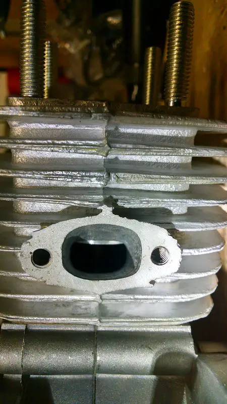

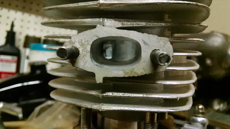

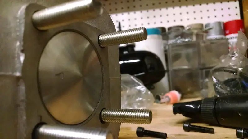

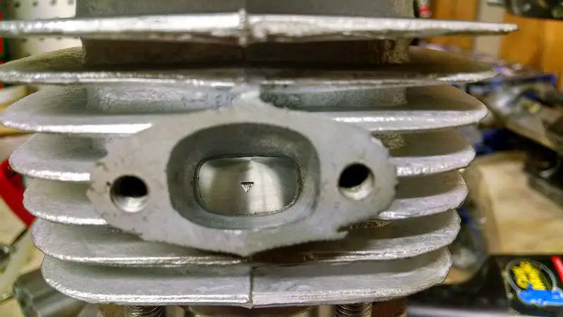

Ok so I sanded down the casting slag on the intake tube, and in the cylinder intake and exhaust sides. That part is done. I don't quite understand the piston notching, I'll look into that more. Kind of get it, but I feel like I need to put the engine together and see TDC of the piston to fully understand how much is needed to clear the intake runner.
Ok...I never did actually get pictures of the 'before' port cleaning.
Here is what it looks like now.
Intake:
Exhaust:
I believe this how much I need to cut off the piston skirt?
It was at TDC when I took the skirt pic (pic for reference):

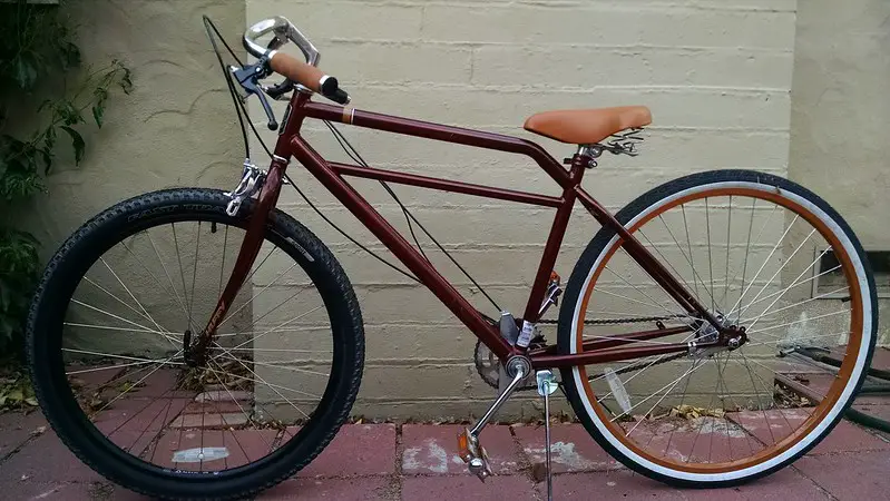

I test fit my the 26" wheel off of my MTB today. I like the look, but my front brake doesn't fit!
I definitely need a new rear wheel before I even bother trying to ride this thing with an engine. Either the rear bearings are already shot or we didn't tighten up the cones enough. I'd rather not find out the hard way, and If I'm taking off that wheel again it's for a new one! Husky doesn't sell a 700c or 27" wheel with a shimano or hi-stop coaster brake...
I really think I'm going to drop down to 26" and figure out a new front brake...which probably involves a new front fork with at least a 2 post v brake mount.
Although...I bet it wouldn't be too hard to make something like that out of my existing fork... It can't be that hard...can it? Drill a hole, weld in some pipe, thread it viola, 2 post v brake fork.

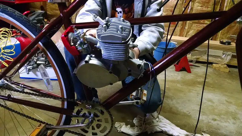

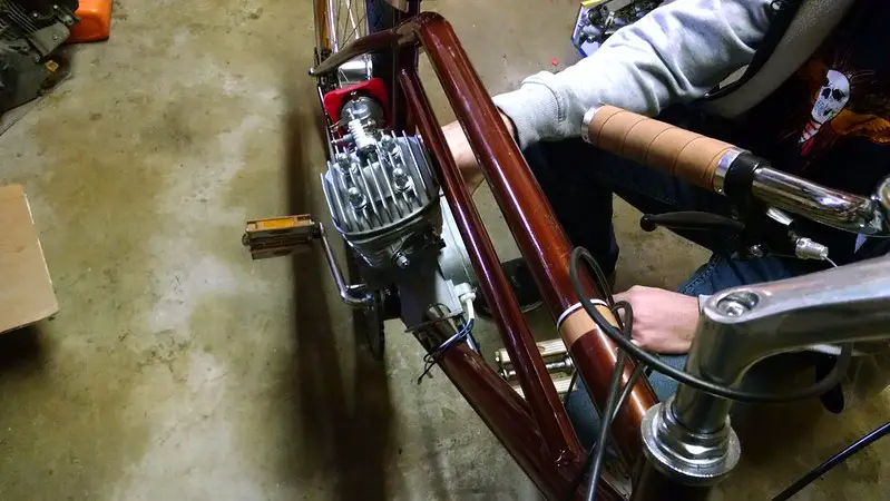

Good news, bad news.

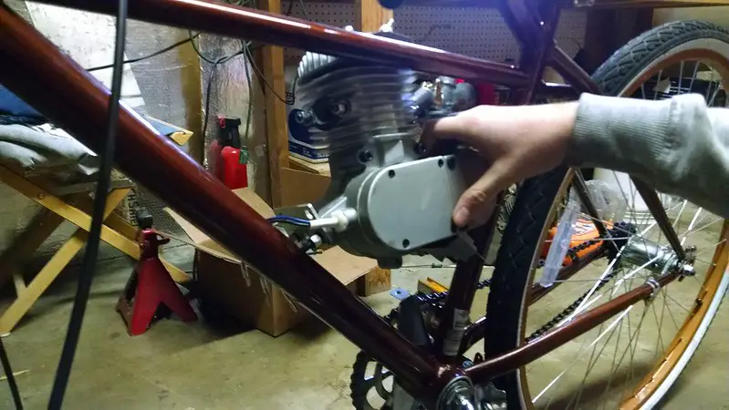

Good news. Engine is put together, ready to go onto the bike!
Bad news.
The lower bar (that I was going to put the gas tank on top of) is too low, and the motor won't fit. Looks like I'll need another bike..
Does anybody know if I can cut that lower bar without repercussions? Right now I'm debating doing that, or just selling this bike and getting another one that will fit the engine...
Don't cut anything on the frame. The only way you can. Cut a bar off of a frame is if you reeled the bar back with supports or what ever it takes. Is it the motor that won't fit or the carb?
First question is, is the frame steel or aluminum? A steel frame could be modified but an aluminum one will require someone with good welding skills. Not easy to find and not cheap.
Cutting out structural members of a bike frame is risky business. You don't know how it was designed and how stress was factored into the frame design. It's not easy to to determine from your pictures what would be a safe route but if it was up to me I'd look for another frame and I'd do some measuring before I bought the bike to make sure the engine woulkd fit.
Now that you have the engine in hand that should be easy to do. I've gone so far as to take an engine to where I bought the bike and did a test fit before I commited to buying it. This was on a 24" mountain bike I built for someone. It was easy to see that I could 'shoe-horn' the engine in the frame with no modifications.
It's definitely going to need modification . What if you forget about motor mount for a second. Can you get the motor in there at all? If you can the. You can make up some mounts if not cut and weld or make it simple get a new frame. Good luck and don't get discouraged ....its part of the hobby!
