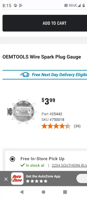

BR7HS .028 gap. is the plug for a 100cc

.026 with little to no resistance
The foot on the gauge is for bending the ground strap straight and even across the gap

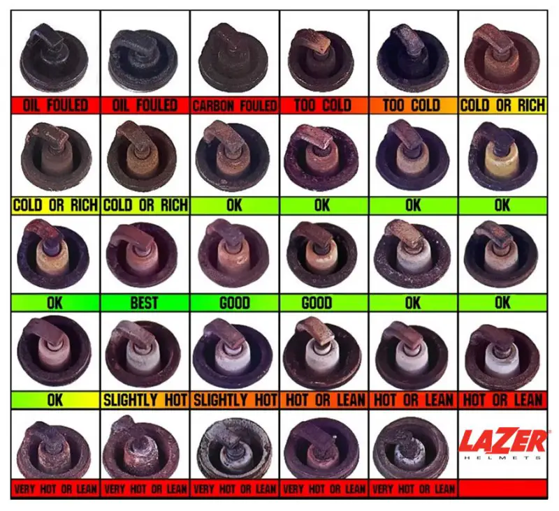

The 49mm is the same cylinder as the 66/80 and would require a 7 plug because the cooling fins are the same but the piston is bigger... The temperature of the engines and the air around it has to do with it... A 6 in a 100 is good for the winter on a 100 and breaking in with extra oil or a spare in a pinch...
Spark plug will tell you if it's too cold or hot... Similar to tuning a carb though trial and error eventually you get everything together...

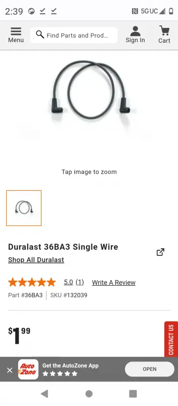

The cap and wire aren't the best on the CDI... I always replace it and it just screws on

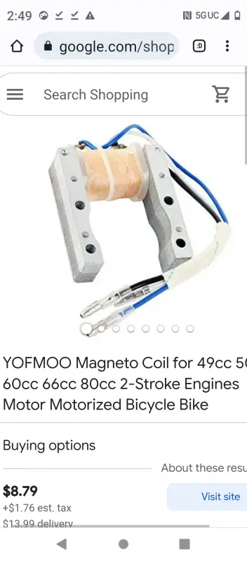

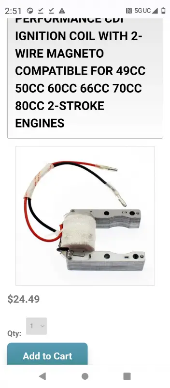

Make sure the mag and magnet have the thickness of a business card all the way around it... If you just got it should have a 2 wire fat mag if it's 3 wire one there's an upgrade for that when in goes out...
The 2 wire has more windings = better spark it doesn't matter where you get from this place sells both and the red wire mag is the one to get... Eventually they all will be 2 wire but there's a lot of junk out there these companies don't want to get stuck with... CDH power is the place to get replacement parts from... The last few years these engines have had some major changes with the design and quality has gotten better you just have to dig around to find it...

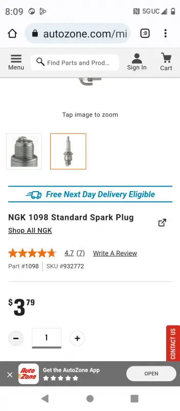

I get ngk boots at our local motorcycle dealer for around $3, you cut the stock boot off and screw the new one on. As Mossy said the stock boot on some cdi units are not made well.

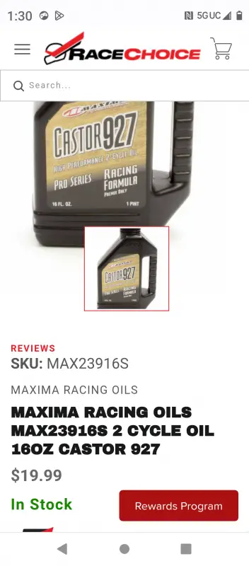

I agree with this on a 66/80cc... Everything bigger go colder and more oil... Rich on the carb... Especially the china kit carb because they run rich lean rich with only a main jet... It's not a big deal just a little insurance on hotter running engines... Maxima castor oil is the best oil

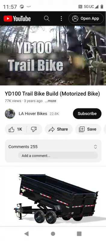

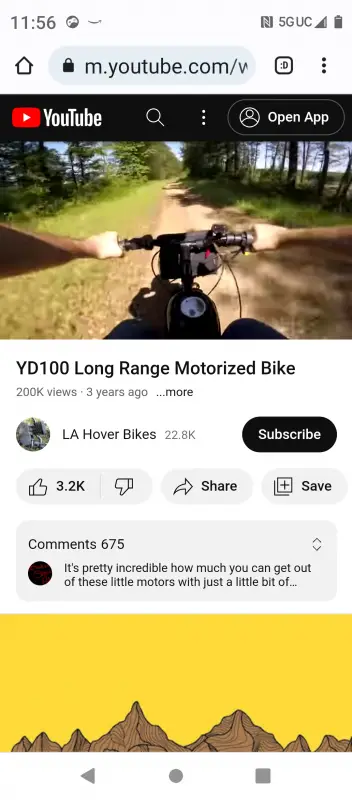

check out la hover on utube

I agree with this on a 66/80cc... Everything bigger go colder and more oil... Rich on the carb... Especially the china kit carb because they run rich lean rich with only a main jet... It's not a big deal just a little insurance on hotter running engines... Maxima castor oil is the best oil View attachment 113990View attachment 113991check out la hover on utube
Cool, I'll check out the videos. Thanks for the recommendation of the Maxima castor oil, as I hope to get a lot of miles out of this build.
I'll check that magneto spacing, and I'll check out CDH power. I have the 3 wire, but most of what I've read recommends clipping off the white wire and taping the end. I think I heard all the white wireless good for is cheap little headlights more running lights, and if you put too much of a load on to kill the engine. I definitely want to upgrade to a two wire, especially with them being better made, like you said.
