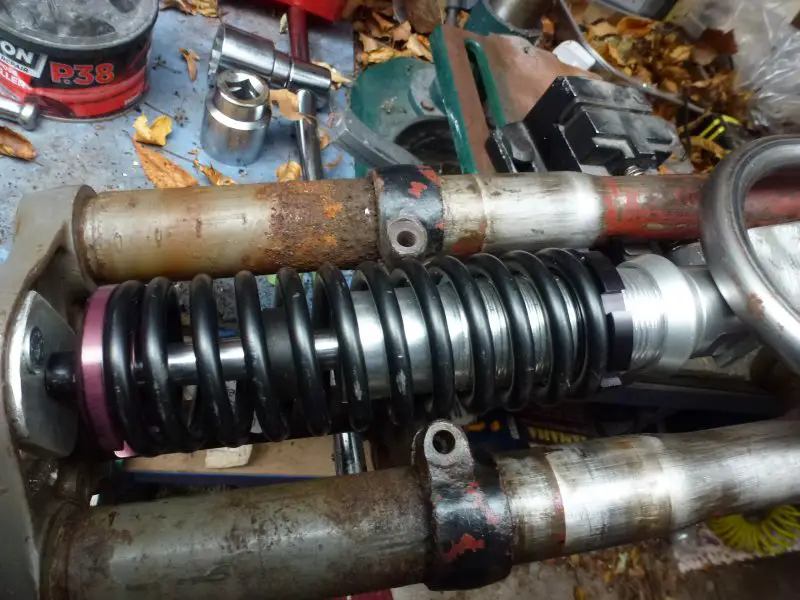

I had three attempts at designing a period looking fork that would work and have proper adjustability. i was fortunate in that the RAM shox I develped have the ability for mounting mods. That shock is a one off ! What can't be seen are the FOUR internal bushes per leg [ stock is 2 ] to give additinal stability.

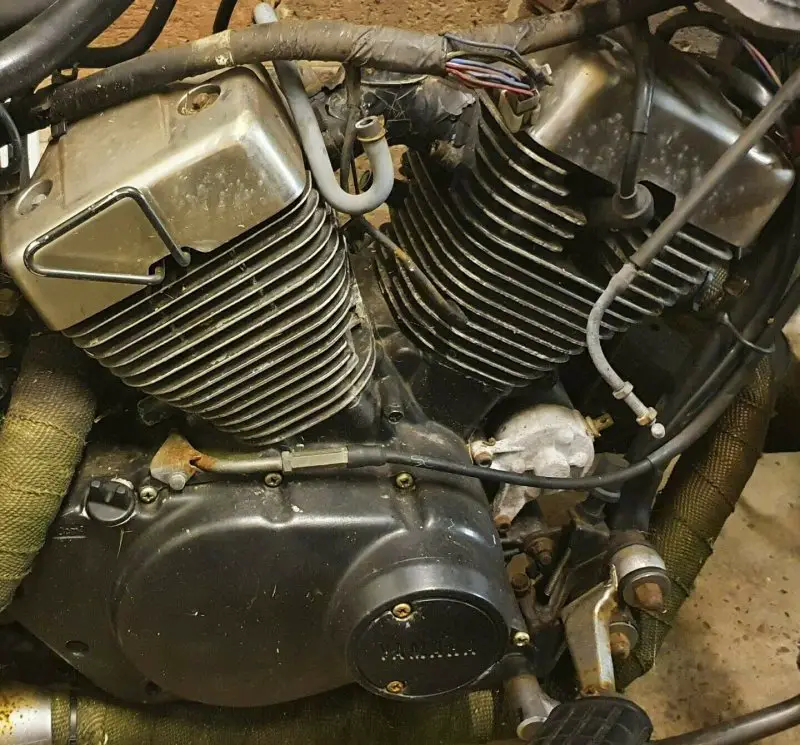

A step closer, I collected the low mileage [ 23k ] 125 Virago lump yesterday.
All complete less carb., and exhaust. Turns over with plenty of compression. initially I'll just use it for setting up the frame, forks and wheels then I'll give it a proper check over.

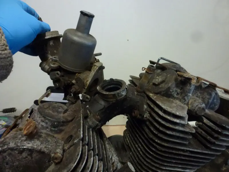

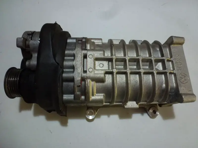

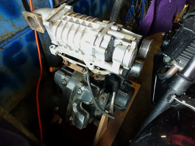

My original plan was to supercharge the VF400, quite straightforward once I can outsource the machine work. However the blower { Eaton ] is going to be too large a capacity for the little 125. However, it was mainly for the "look". I'll have to do some calculations to see if I can underdrive the blower sufficiently [ and efficiently ] as it's the period look I want. Plan B will be an SU carb on a swan neck manifold.
I'll be up the garage in the next day or two to check out the viability of the blower.

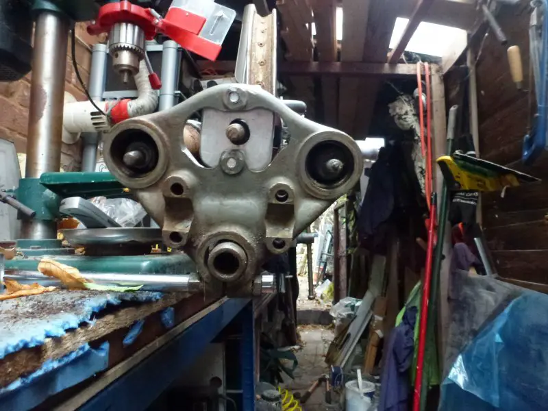

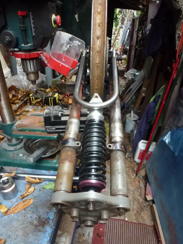

The Bantam fork legs are finished at last. They now have 3 bushings in each leg [ standard is 2 ] to cope with extra weight / performance. Also the Honda wheel spindle has been modified to fit into the Bantam bottoms and spacers made up. Next job is to assemble the front end complete and mock up the mountings for the Shock and adjust the front hoop length so we can get the weld bungs installed.
The forks have been fully mocked up and work has begun on fabricating the front support hoop - bracket mounts and weld bungs for the adjustable clevises. We're also fabricating the top mount plate for the shock top mount. Feel like we're making progress now.

I also played "whatif" with the 1 1/4" SU carb and found a sweet spot for it - just got to find someone to fab the manifold now.

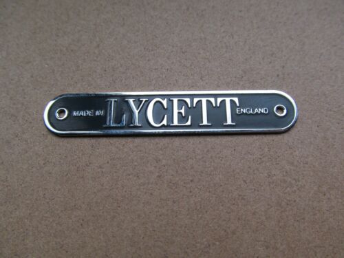

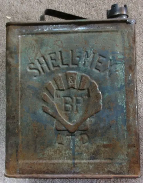

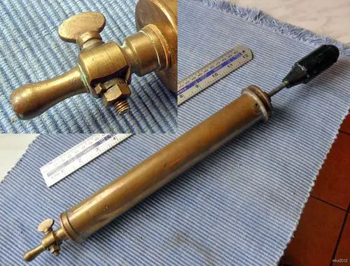

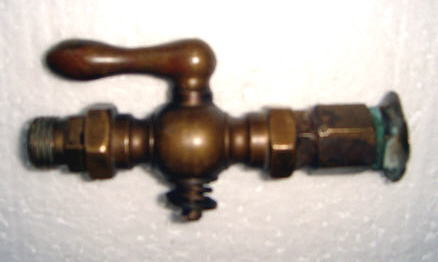

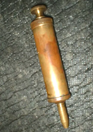

Here's some goodies I collected a few years ago when I was contemplating building a Boardtracker.
The 2 gallon petrol can will be used as the actual fuel cell mounted low behind the engine and the tank is a dummy [ shape to be modified ] and all the squitter will be hidden underneath - battery, ECU, fuel pump, coils, etc. I have another fuel can which has been cut down to give about 1 1/2 galls.
I've found someone that can do realistic Brass powder coating. Carb body and float, tappet covers and a few odd bits.
