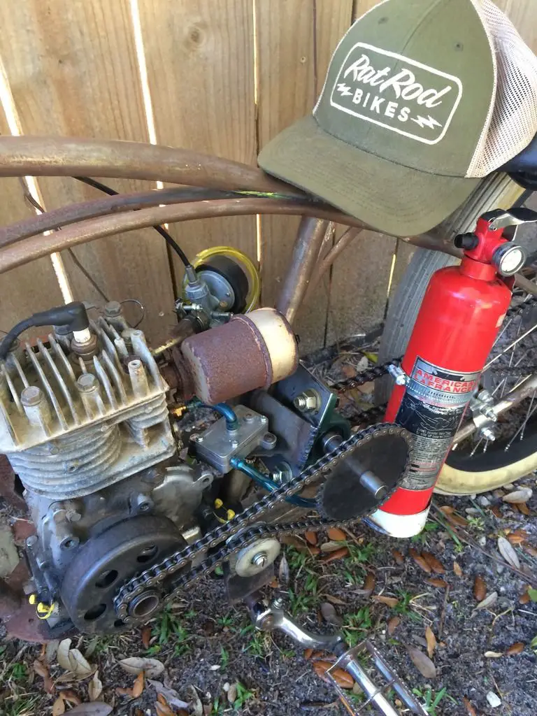

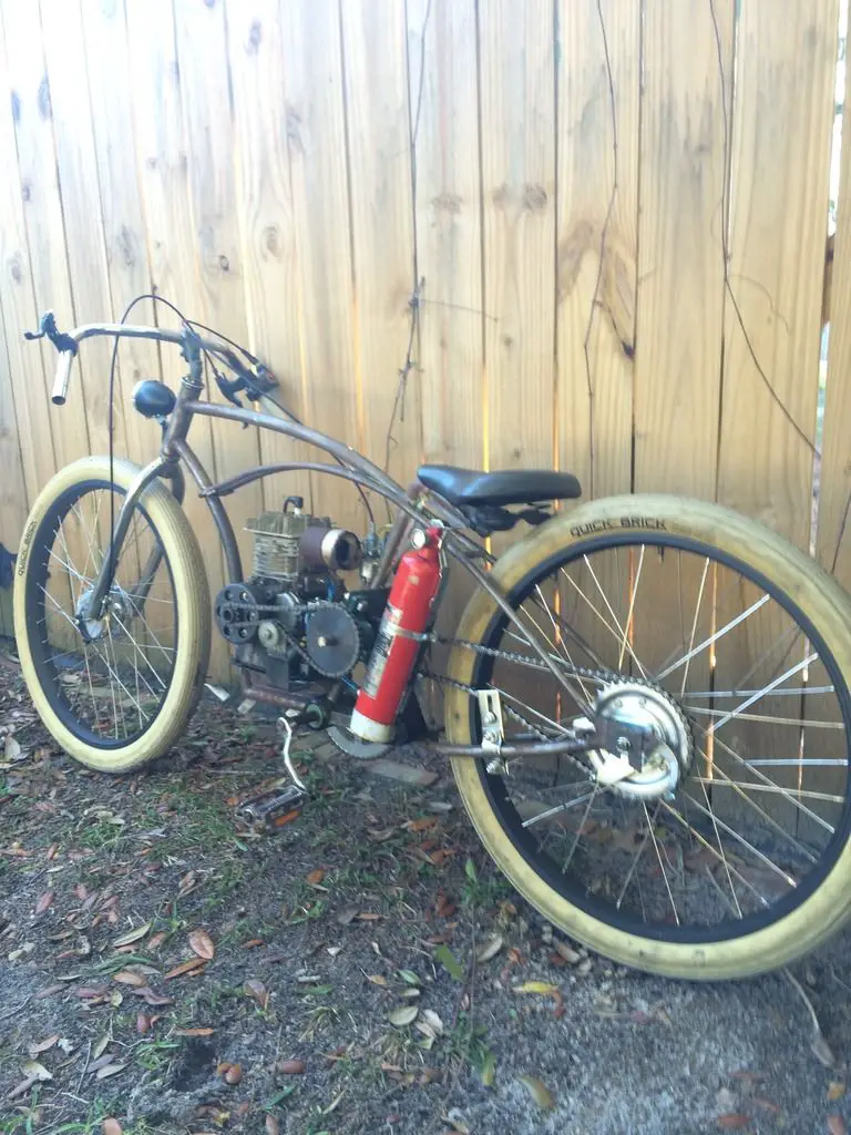

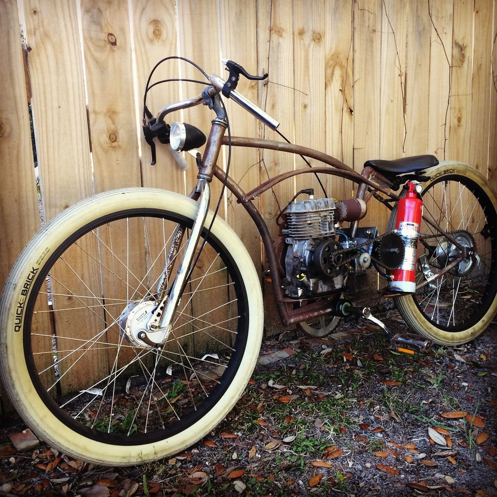

ok looooong time no post. update i have for you are. found some new handle bars i like a little better. updated my jackshaft to pillow blocks. completely blew out my old setup. also new rear moped hub. completely blew out my rear 3 speed hub. i destroyed everything on this bike. she only goes 32 now but thats just fine with me. also installed a fuel pump and the new gas tank is a fire extinguisher! i have a lot more i want to do with this bike but for now she runs great for the most part.
