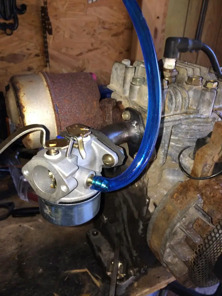

That is right, so the Tecumseh clone has two needle adjust screws. It is meant to have the engine idle. See post 23 second picture attached. If I order and find out that the filter needs extra parts to attach to Tecumseh clone carb, not only will I have to get the part and wait, but extra cost.
I am already considering possibly a whole different engine all working.
Anyway where does the airfilter alone gonna be able to attach to the far side in the picture of the Tecumseh clone carb? The throat and holes are tapped for screws in the carb intake. I can't see how at all the filter by itself can attach.
What I think Amazon and others are having both bundled for is those who already have a Tecumseh Engine with Tecumseh Carb and are replacing the carb, so why not get a new airfilter. I am such that I am mixing brands and do not have the backing plate or the filter housing, so it means more cost. When I'm done I have already paid half the cost of a new HF 99cc on sale.

Not a problem, I have the air filter and housing now and tomorrow the carb to see if they fit together. If not I'll make it work anyway. I already have made the connection to the carb to an angle manifold that was what was lying around with an adapter. Second adapter added to it so the the float bowl is level. I'd ran the bike fine with those adapters. I'll be able to reuse all the adapters, but might need some I'll make if needed. An NT carb may have been a way for me, but my carb to arrive is the Oregon one that is a clone Tecumseh with two adjustment screws. It is very much looking like an easy swap.

Now I have a Tecumseh Clone Carb with all the adjustment screws and a filter housing and all and it fits. The mounting is all the same as the Briggs. Only I have to get the throttle hooked up and see where one carb is ccw for throttle and cw for the other. I'll find it an easy enough fix to just use the major return spring and cable on opposite sides. Note this Tecumseh Clone carb has a spring but too weak a spring for the twist grip throttle to return.
MT
All total including tax and shipping about $40 for the carb and filter housing (that is without the paper filter) that is like $5 more if you want it.
Last picture is of the Briggs carb without adjustments, I'll swap out. It is just to show that the mounting holes to the engine intake and the gasket from the Tecumseh carb are the same!

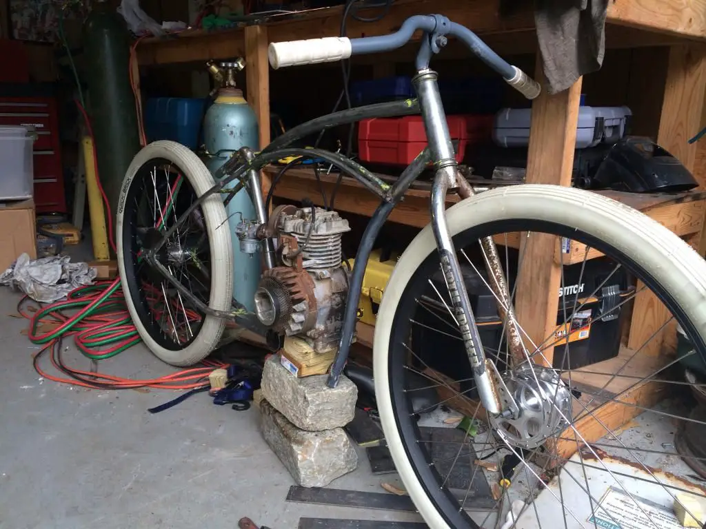

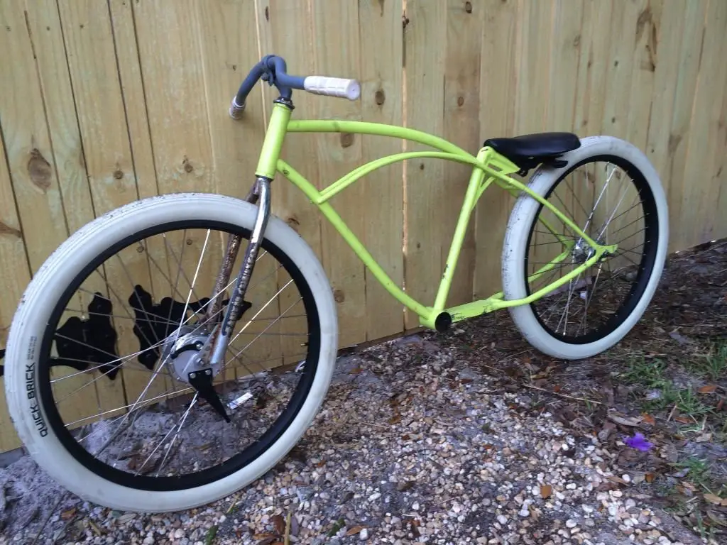

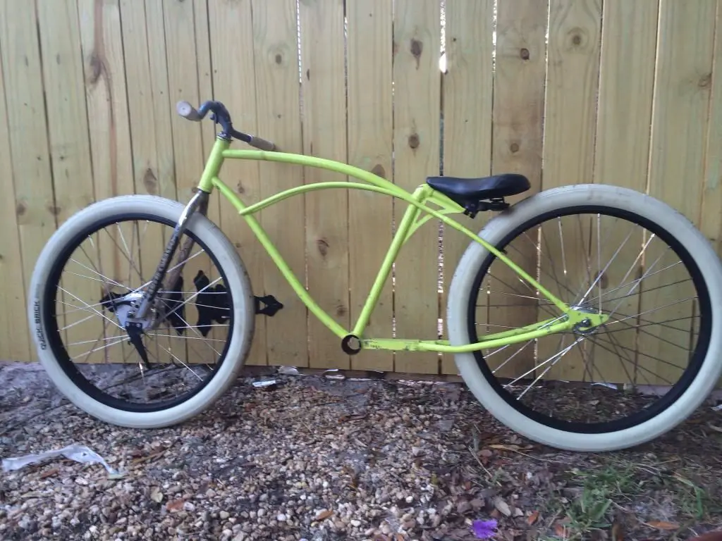

Slowest build thread ever I know. Anyways. Put the new rims on to see what it's going to look like. 12 gauge spokes. Sturmey archer 90 mm drum and 3 speed in the rear
Looks good! There's a lot of competition here for longest build ever. Fasteddy & I are neck and neck with our tri-car builds at about four years now... heading into the final year's home stretch.

Yes 26". Also heated up and bent the frame to make room for the motor. I wanted it sit straight so this is what I had to do with what I had to work worth
