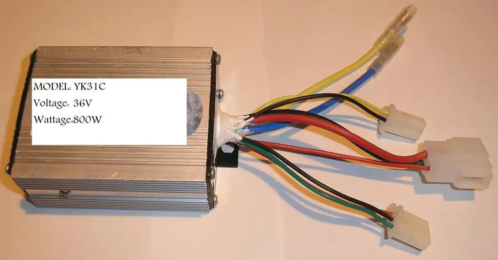

My new controller also arrived £17, this one's a bit simpler with the wiring...

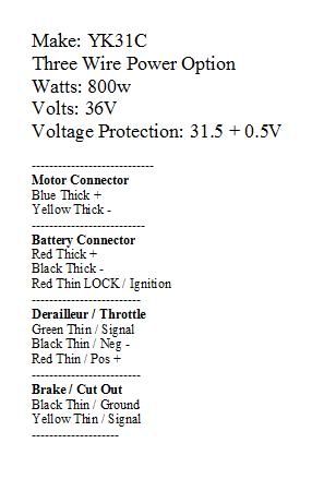

As to the wiring of the new controller...
I discussed the wiring with the seller before I bought this controller, he said I had all the wiring figured out, the only wire I was missing is the THIN red wire this needs to be connected to a switch and then + power back to the battery.
As I dont have a switch handy I just hooked this straight to the battery.
