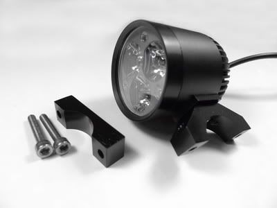

I also fitted my new rear rack box on and my new LED light, wow this things bright, you can see it in the daylight.
Rear Box.
LED Light.
Im going trailer testing now, i'll fit my new bike tyres tomorrow.
