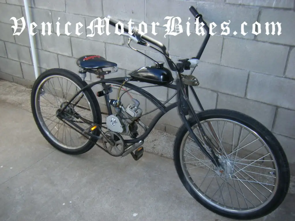

Here's a little update on the Bomber...
The guy who bought it, spray painted the whole bike flat black & also cracked the frame from "riding it really hard".
He lives in Malibu, so the bike is looking real dirty & crusty now...
It still runs really good & is crazy fast!!!
I was able to weld the crack without any problems; but this is the first bike to crack where I drilled through the frame to mount the engine.
I think I'm going to start re-thinking drilling the frames on the bikes.
Yeah, the through the frame mount is definitely not the shizzy.
I've heard of a few lately that are cracking/breaking. A hole should never be drilled on a load axis of tube, it's going to break sooner than later.
Hey fellas... heres a pic of my personal bike that I call "The Bomber", because it's army green, rusty & real fast!
It's a 1970 Schwinn, it has a PK-80 engine, 36T sprocket, upgraded plug, wire & boot, I port matched the intake & exaust ports, I removed the exaust baffle (YES! it added a lot of power!) & I added a K&N style air filter.
My next mod will be to figure out how to beef up the ignition system!
So far, I've built seven bikes, & this one is the fastest!

This bike is sold now... I only have it in my possession to fix a crack in the frame.
But I'd still like to see the link!
If you guys are going to drill through the frame for a bolt I suggest you drill a hole large enough and weld a tube through the frame for the bolt to pass through.
