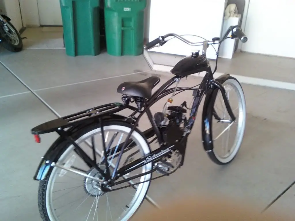

Just finished my second build, and I am having some difficulties. When I ride the bike hard, it bogs down quickly. It seems like it is starving for fuel. I have checked the plug, and it is a sooty black, similar to my old bike, which was oddly problem free.
Quick pic of my bike, hopefully soon to be problem free
Lots of people I know are having the same problem bogging down at high reves 4 stroking at high reves A friend of mine was so sick of it he bought a new carby and its worse than ever doesnt matter where the needle is set (ritchest or leanest) its the same all the time if you do work it out please let me know thanks mick29 PS happy rideing
Fixed it. Luckily my problem was simple. The choke lever would bounce up and down when vibrated under high revs. Took off the airfilter, tightenened the choke lever nut and bam, problem fixed.
As simple as that, what a releave I was rideing my bike yesterday turned a corner and the bike motor dyed I had bumped the chock lever with my leg THE SILLIEST things happen thanks mick29 happy rideing
