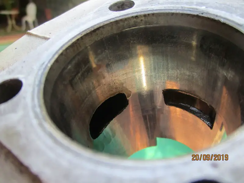

hi there, i have already pull the head cylinder apart. Is there anything in particualr i need to look for?
as for the above three, their is spark, there is fuel and air, so it must be compression. I just dont really know what to look for

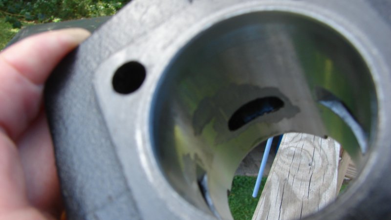

Let's go back to the beginning. When you stated above you had your cyl. off. Did it look like this pic?
I don't understand why you have not answered questions I have clearly asked. I put out to to help you. I am not an ego driven know it all. I'm Just trying to help that's all. GET YOUR DARN COMPRESSION CHECKED. The end...
if tht was my jug, i'd change it. gotta be leaking like a sieve.

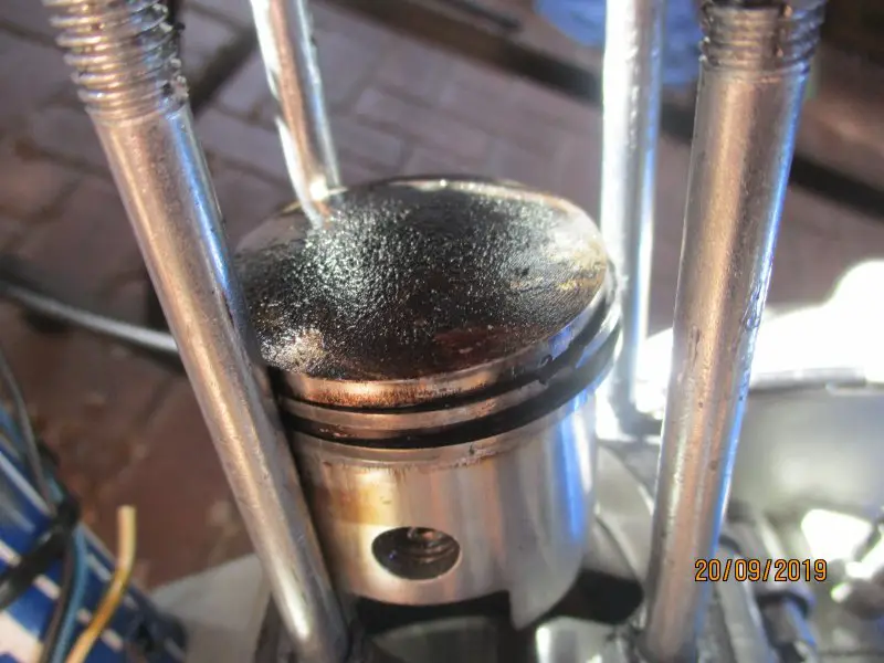

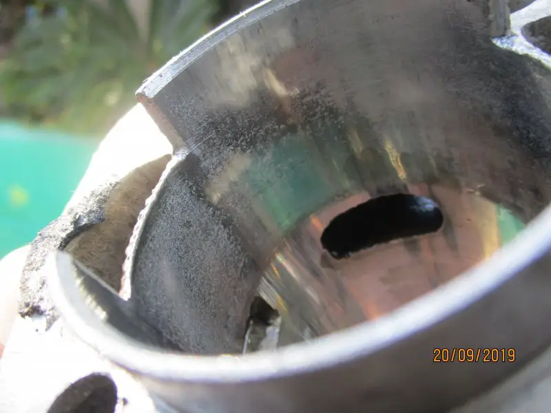

it looked like this

Scrap my previous reply --------after taking another look at that cylinder obviously it is spauling/flaking, replace it and start over.
it doesnt feel or look like its peeling though. it just has a couple different coloured lighter spots on it and when i run my finger i cant feel anything bad. Do you really think this is the problem?

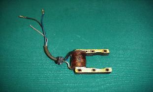

Now- how about the magneto,,,, that would be that horse shoe shaped part which surrounds the spinning magnet with the wires coming out . These Do go bad.
http://thatsdax.com/ENGINE_KIT_PARTS_PAGE_1.html
Yes, I checked that little magnet, and the magneto, nothing looks wrong with it, it still has magnetic force, and for that picture above, I swapped that with my friend and it didn't make a difference.
