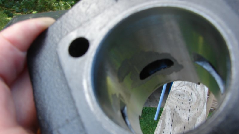

So after all this...
hi there, i have already pull the head cylinder apart. Is there anything in particualr i need to look for?
as for the above three, their is spark, there is fuel and air, so it must be compression. I just dont really know what to look for
cheers
Let's go back to the beginning. When you stated above you had your cyl. off. Did it look like this pic?
.jpg
I don't understand why you have not answered questions I have clearly asked. I put out to to help you. I am not an ego driven know it all. I'm Just trying to help that's all. GET YOUR DARN COMPRESSION CHECKED. The end...
