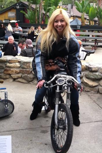

![dscn0144_lg[1].JPG dscn0144_lg[1].JPG](https://motorbicycling.com/data/attachments/34/34275-df3d5ce6e0247cd8a9a347056da5ed2f.jpg)
1975 Silver Fox Motocross

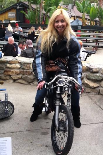

The bike was almost finished. I scavenged parts from my other bmx bikes, maxis freaky x tires, rebuilt the rear hub, used a small bmx sprocket in front.
First run was the day of the show and she ran real nice!! Was able to fire up for the 12;00 smoke out!! Fun show !! I went with my buddy that is chasing a 50cc land speed record of 86mph!! ok ill save the boring chatter now and show some pics.
Let me know what you all think please!
