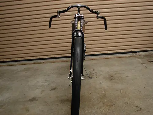

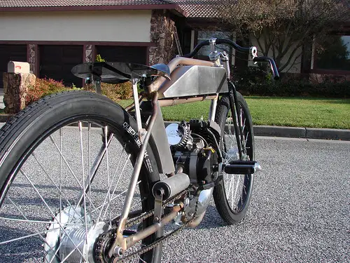

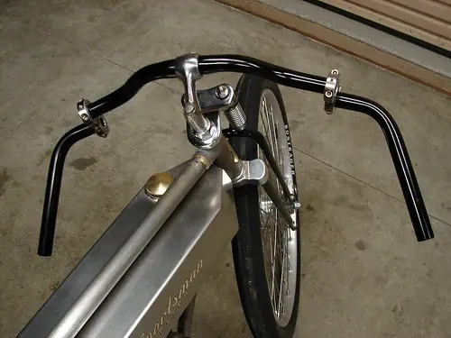

Since this thread was bumped up I may as well update it with revision 3 of my boardie bars. Finding the correct bends to get the look closer to my idea of what looks right has been a challenge. Here is the latest attempt. These bars are aluminum and only come in black. The bends are pretty close to what I want.
Sportsman WZ Flyer by Sportsman Flyer, on Flickr
wow front pic looks mean...what size tires are those? and is that a 3spd rear hub? bronze front badge is cool too
wow thats a bicycle. what rear hub is it? and that drop loop in frame is perfect. and exhaust is too. have a new background on my pc. great build

I GOT MY BARDS TODAY FROM PAT WOO HOO!! Ive been watching his bars from the beginning. First ones were cool but not quite right for me. Second ones raised my eyebrows. Now the 3rd ones were a must have!!! Pat there dead on for what i was looking for!!! THANKS again!!

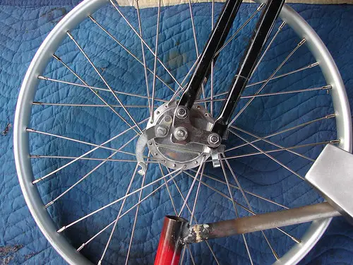

Hey Pat, purchased a worksman front wheel with drum brake, will be mounting on a monarch also, I noticed you have your brake arm on right side, wondering how you mounted your stop bracket, trying to figure something nicer than a strap. Cant get a good close up on yours.
Hi Joe,
The right side mounting of the brake arm was causing the forks to bind. Norm at Venice Beach MB's came up with a much better approach. It requires a modified rear shoulder bolt with welded on pin. It works great.
DSC06035 by Sportsman Flyer, on Flickr
Thanks, tried putting on right side also, thats why I questioned that, had same binding problem. Great idea with modified shoulder bolt. Back out to the man shed. Thanks again for the great pics. Joe

Yeah, Basically I found out real quick that something was keeping the fork from moving up & down; so I looked at the drum brake & found that it's center is fixed to the fork dropouts & must pivot with the dropouts as the fork springs move up & down, & that the pin that locks in the stop bracket on the drum needed to be relocated to allow this.
It was actually pretty simple to figure out because I had already worked out similar problems when I designed my disc brake bracket for the Monark forks.
Pat & I will certainly be offering the modified shoulder bolts with the stop pin as a option with the Monark forks soon. (^)
