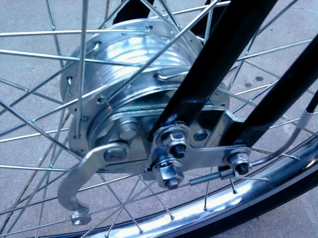

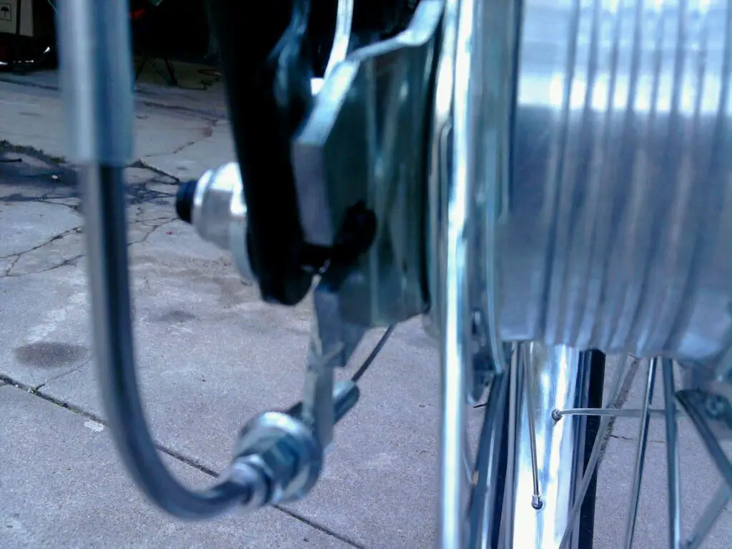

Yeah, Basically I found out real quick that something was keeping the fork from moving up & down; so I looked at the drum brake & found that it's center is fixed to the fork dropouts & must pivot with the dropouts as the fork springs move up & down, & that the pin that locks in the stop bracket on the drum needed to be relocated to allow this.
It was actually pretty simple to figure out because I had already worked out similar problems when I designed my disc brake bracket for the Monark forks.
Pat & I will certainly be offering the modified shoulder bolts with the stop pin as a option with the Monark forks soon. (^)
Here's some pix...
