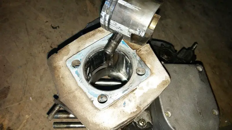

    Today my wife was riding her bike to work about 15 miles away and her engine seized up. Was a pain in the ass to pull the motor apart, the metal was all melted together.
    Swapping the motor out for a new one tonight when I get out of work at midnight.
    I estimate it ran for about 850 miles before the failure. Mixing at 32:1 and it was stock. I plan on adding a 6.0 cc head and a banana pipe for the next motor tonight. I hope that should keep it cooler.
    I have a spare reed somewhere too but last time I tried it I didn't like it on my bike.
    [​IMG]

    So does it look like pin retainer clip failure or an exploding wrist pin bearing? I can't tell.

    Wrist pin bearing was okay. The wrist pin itself had the bearing melted into it then looks like the piston dome smacked the transfer port.

    That wrist-pin is SUPER PITTED! How'd the motor sound before it detonated?

    Are you SURE it had oil? Sure looks like a classic dry seize to me.....

    Yep drained the gas and it was blue just mixed 2 gallons of 32:1 last weekend. All the other bikes have been fine on that gas.
    She said it slowly just died then locked up the rear wheel.

    Sure sounds like one too. Most likely a cylinder plating failure then.
    I hear there have been a rash of jugs with bad spots lately, and I recently saw one myself with a dime sized defect, luckily BEFORE using it!

    Could have been a bad crankshaft oil seal. This will cause a super lean mixture due to air being partially sucked in through the bad seal instead of the carburetor thus leaning out the mixture. I've repaired several 2 stroke motorcycles that befell this fate. The best thing to do if you have a means to do it is to have the bottom end pressure/vacuum tested. It also could have a splitline seal failure or a crack in the crankcase. A quick and dirty way to check for a bad oil seal is to spray starting fluid around the seal area, if your engine picks up a lot of RPM you probably have a bad oil seal.
