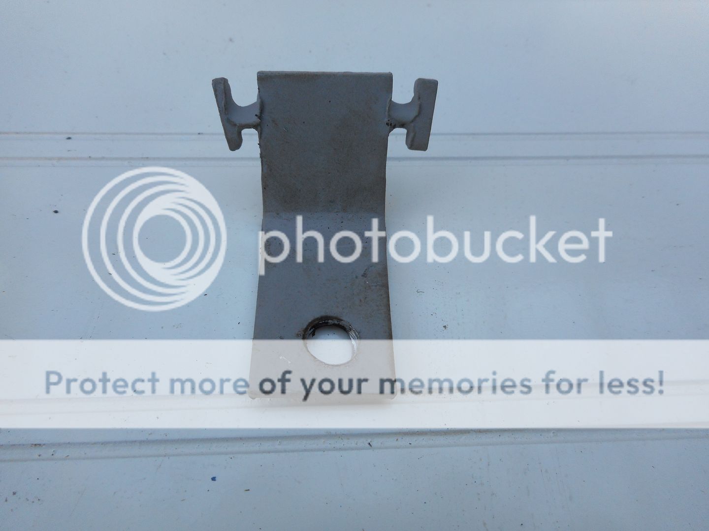

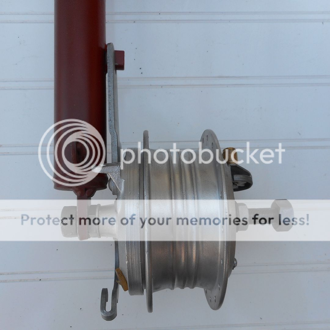

Bill welded the tab onto the fork leg the brake plate slips into. Now I can paint and assemble the forks and lace the front wheel.

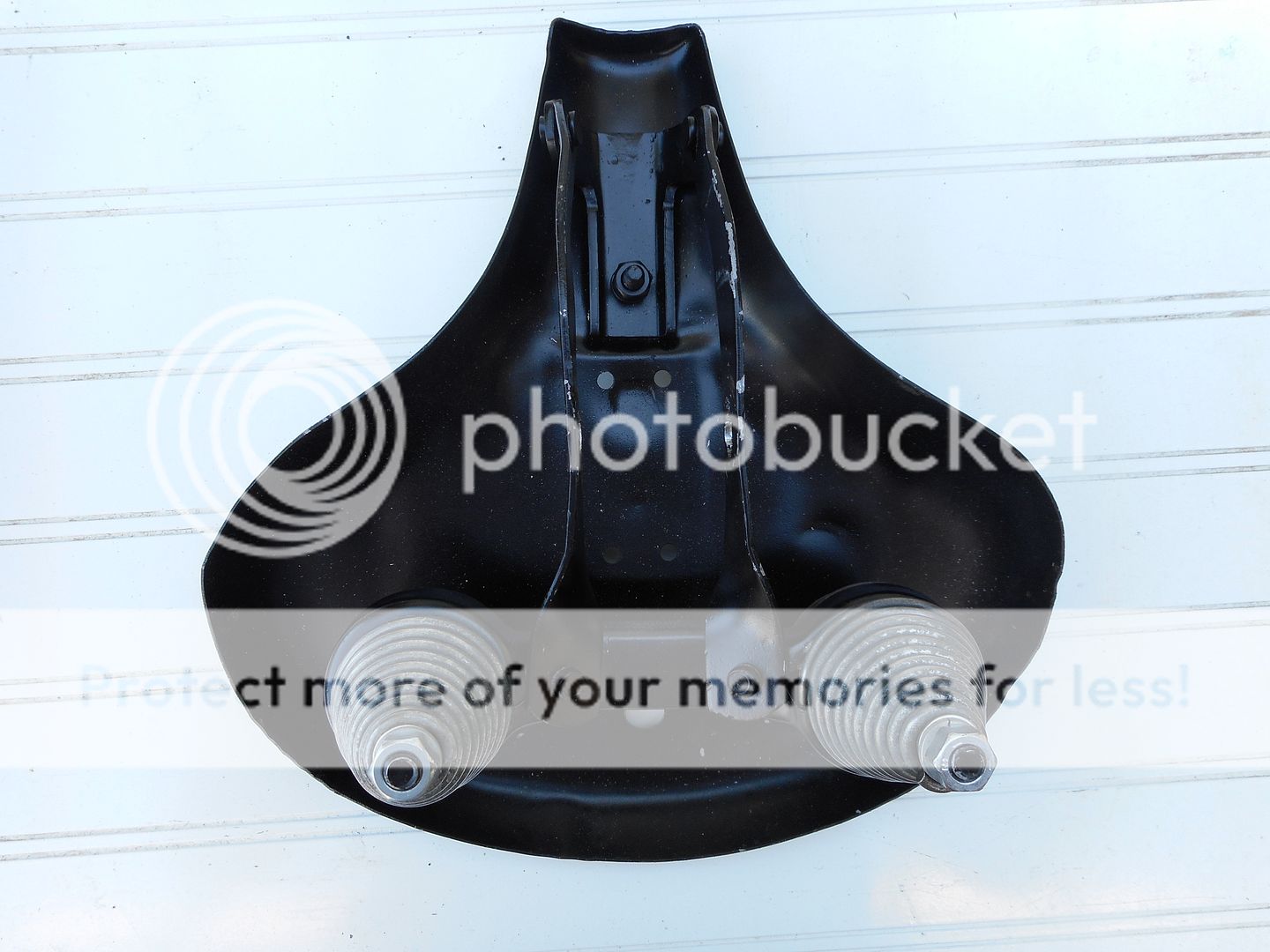

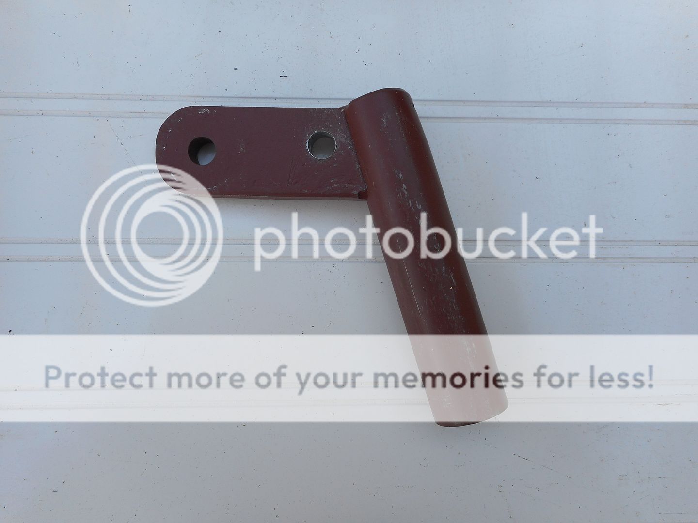

The pivot on the front of the seat Bill bought at the long Beach cycle swap is worn out and I needed to replace it with one that is wider so the seat can slip down over the tube.
So I cut a new bracket from a 1'' X 4'' heavy wall tubing and bolted it to the seat pan.

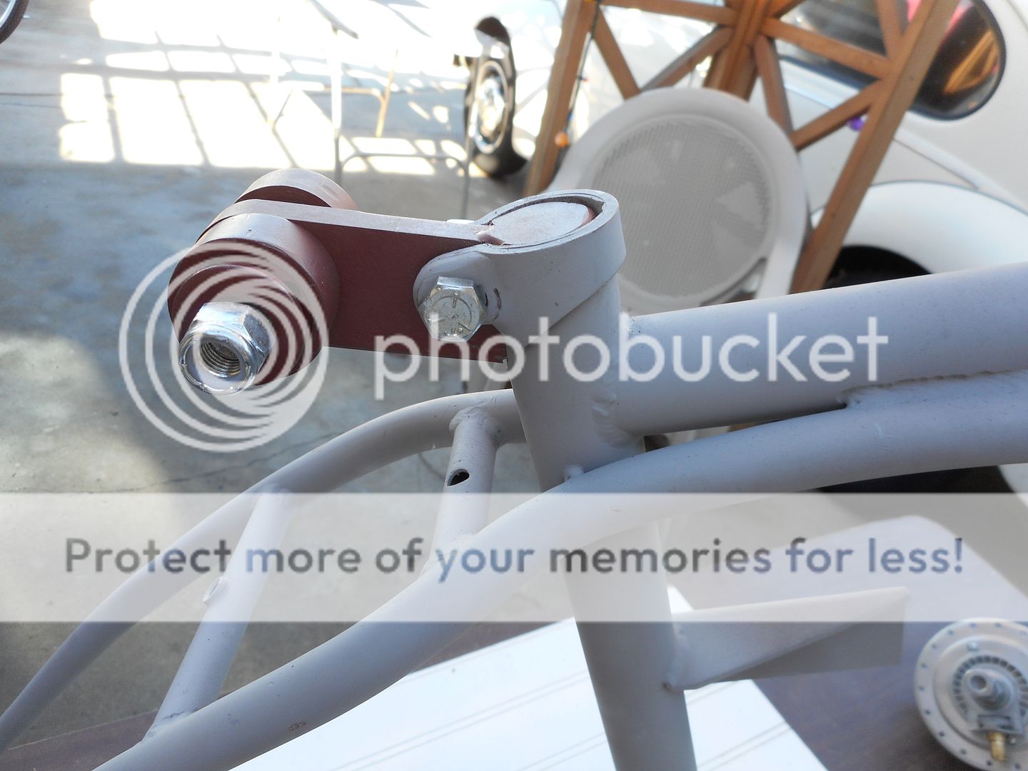

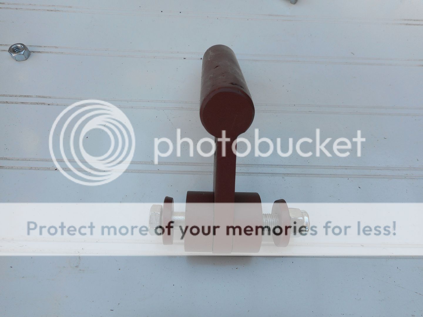

Then I made a seat mount using 1 1/4'' X 3/8'' thick bar stock welded into 1'' round stock at a 20 degree angle so it is level.

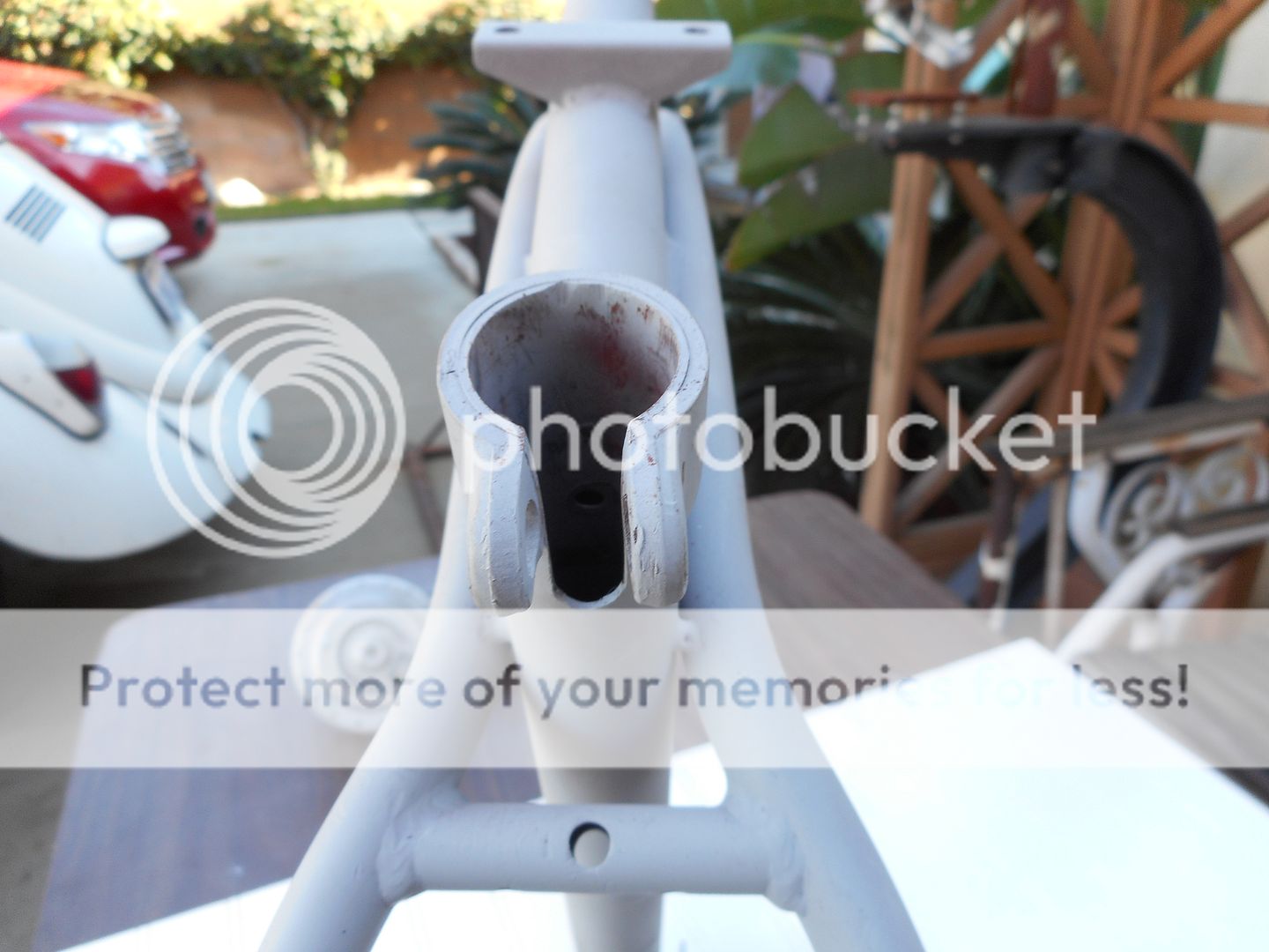

By opening up the slot at the pinch bolt, my mount can slip into place.
Add some spacers and heavy washers and it's ready to install.

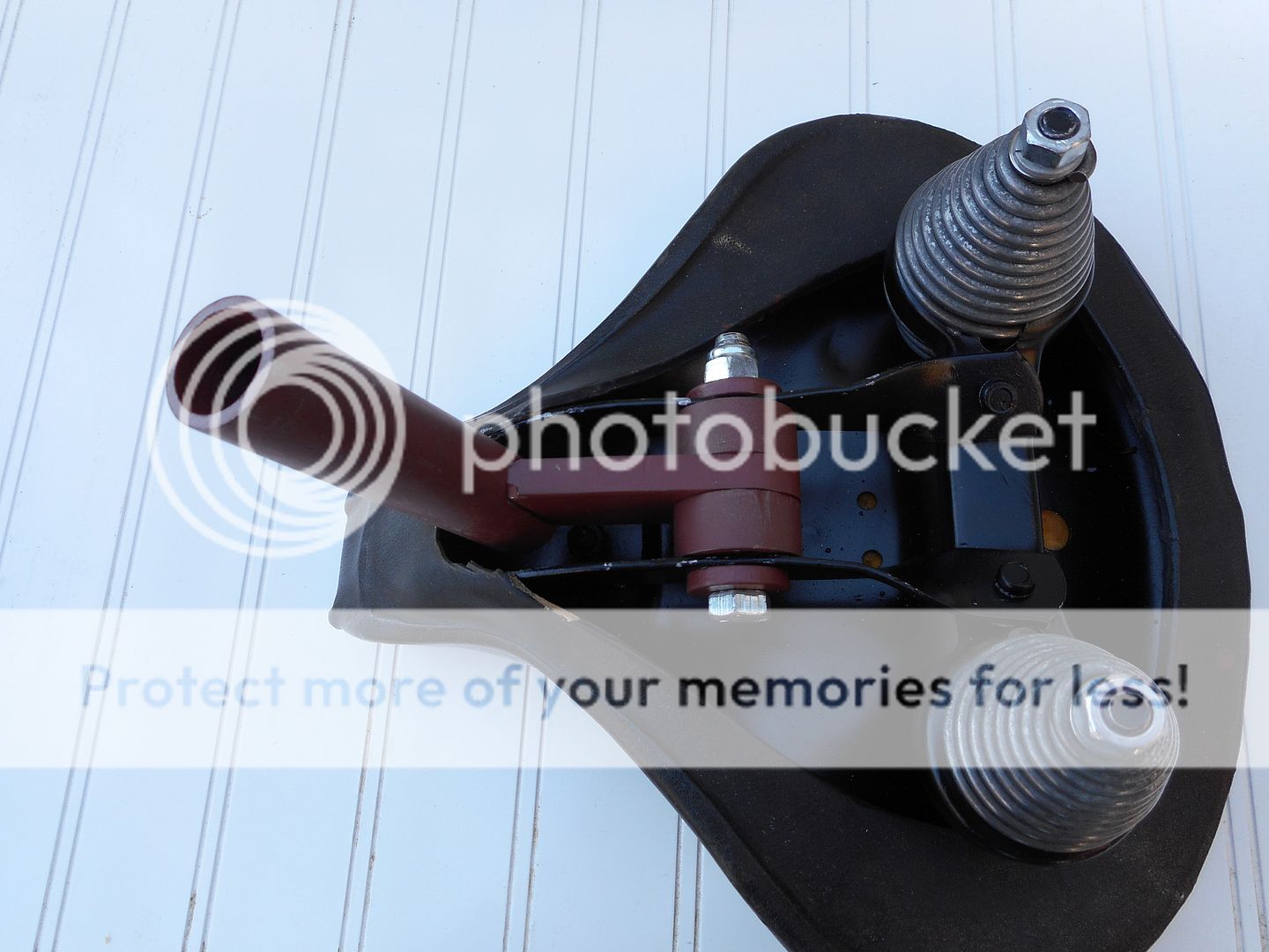

Fit it to the seat.
The pinch bolt holds it in place.

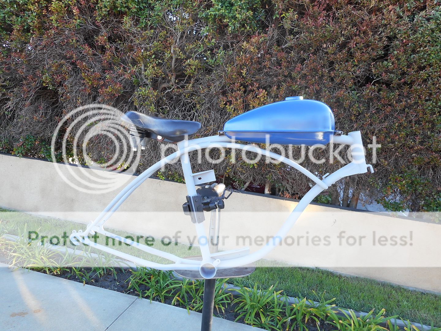

Now it's is back and lower for a nice transition from the tank to the seat.
Bill's whizzer restlying is really shaping up. Lowering the seat and front forks will make it look more like the vintage whizzer. Dales getting Bill's wheels ready, saw them yesterday, gonna be nice!

Very cool Dale and Bill, thanks for the loan of the Kohler for mock-up purposes. Bill, your going to have to move the seat over the rear wheel by cutting/welding the seat post at 45° .
This will be a very nice motorbike when your done...

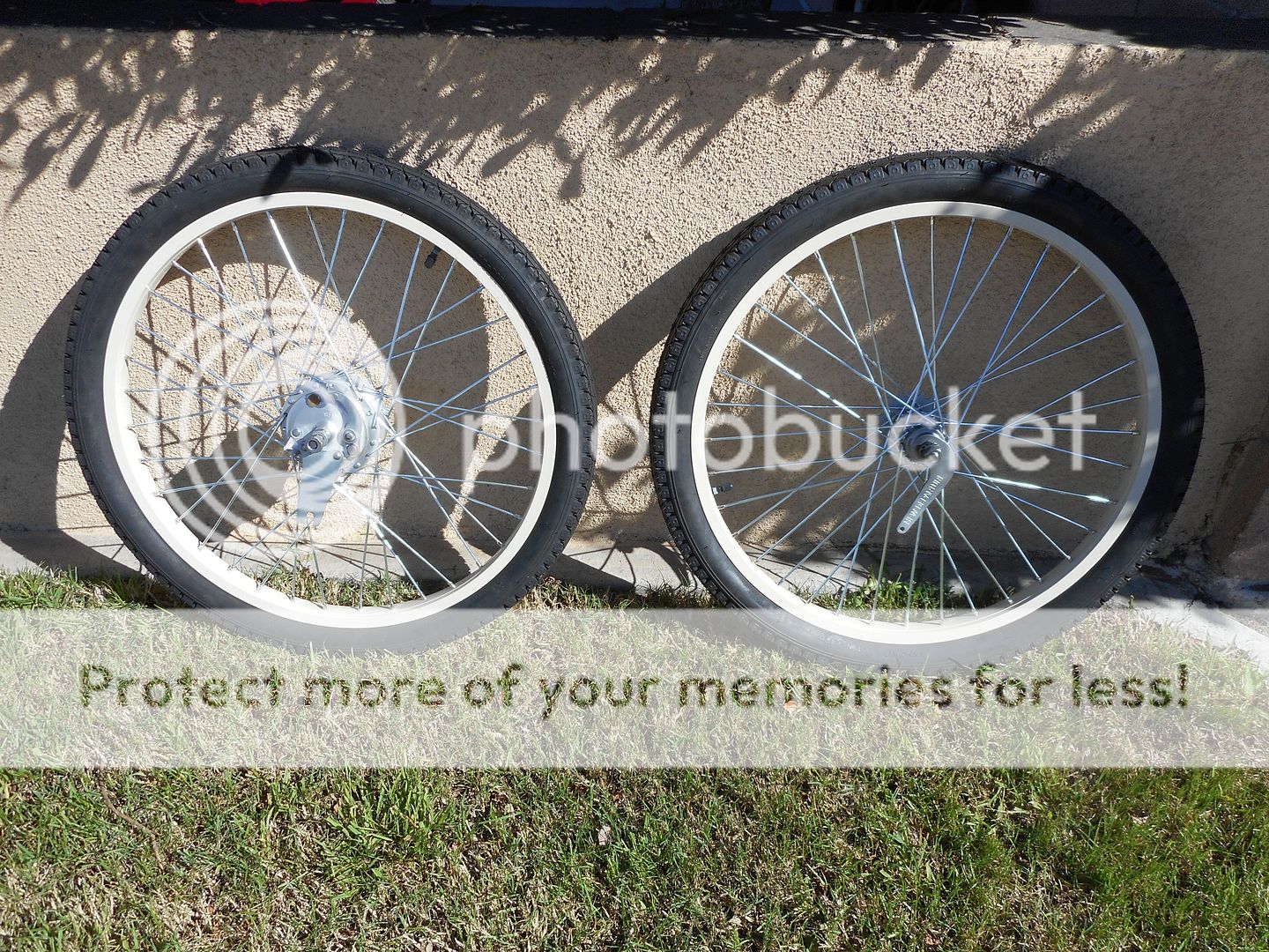

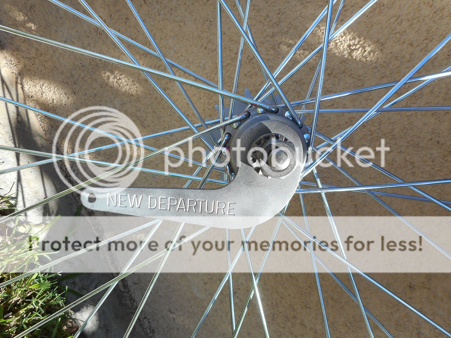

Finally got the correct spokes and both wheels are ready to install. Maybe Bill can score a skip tooth chain and we'll make it look older yet. I have lots of skipper sprockets.

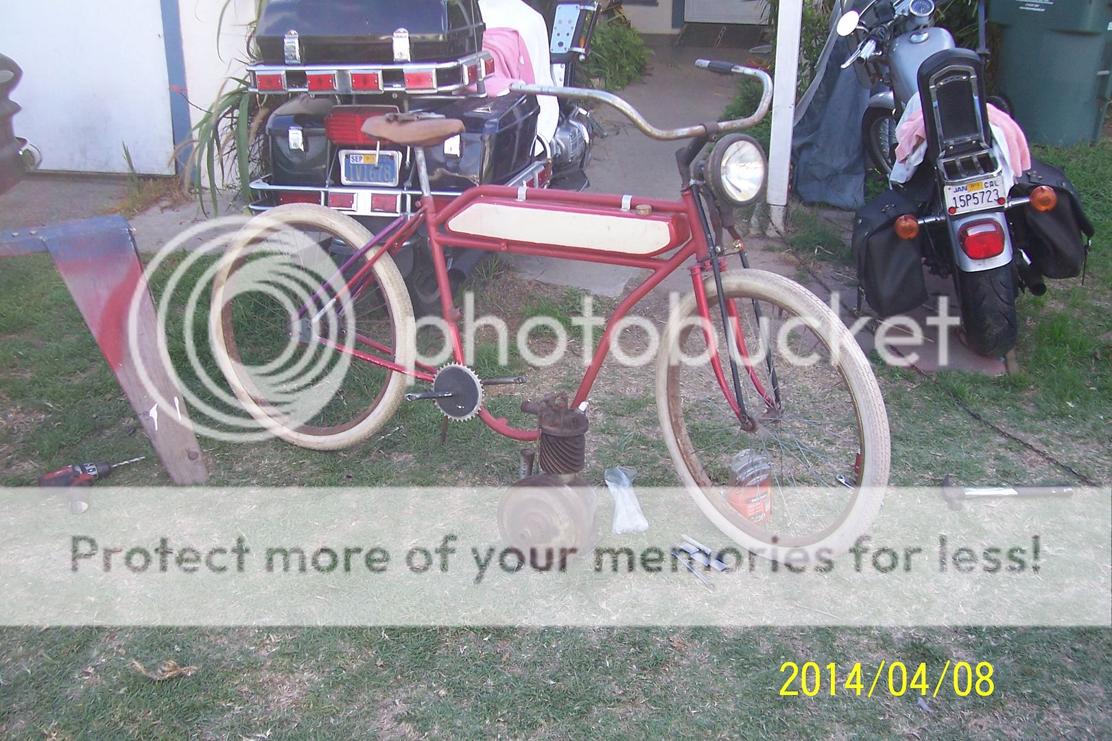

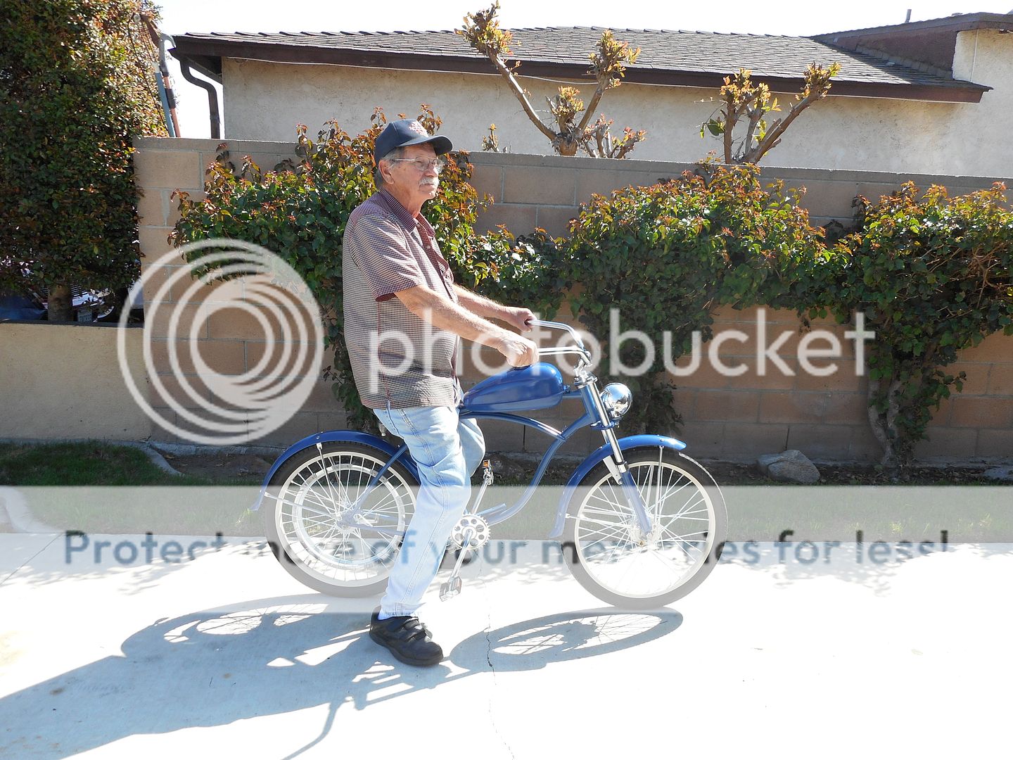

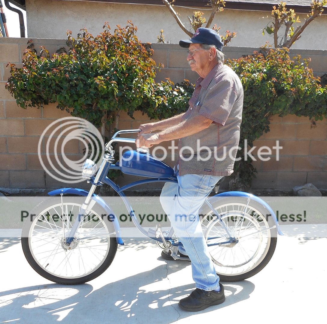

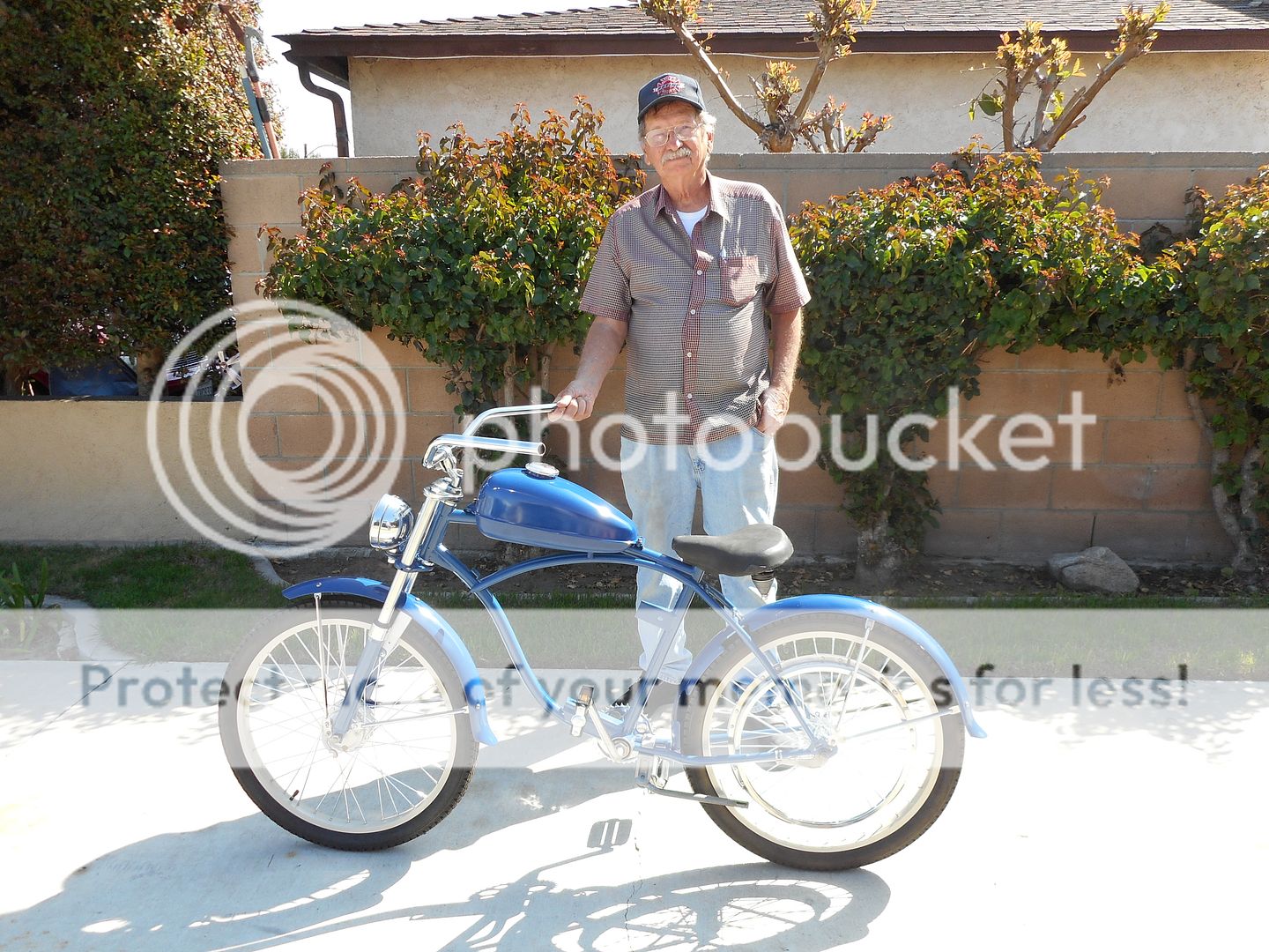

Finally back up on 2 wheels. This is the look Bill and I were trying to achieve. Still lots to do, but made some good progress today.

msrfan,
Is Bill a really big guy or is that a 24" frame? It looks small, but looks real good, too. What is the engine on his next project? Looks like a custom frame.
SB
Yes silverbear, Bill is just 5' 17'' and it is a 24'' Whizzer. He makes every bike look small.
