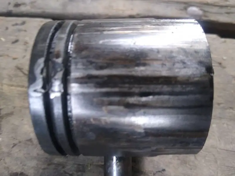

Thanks guys for the help. I think I found the problem I took the head off and seen the rings just fell to the ground in pieces and the piston looks like this. So would that be what causes it to just move freely and not start?

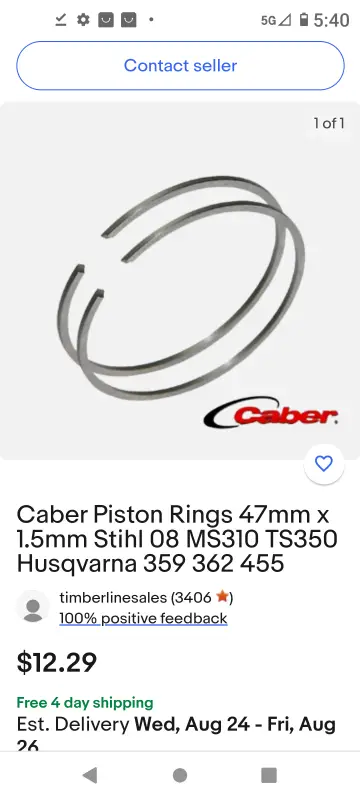

Just cheap parts might have been broken from factory... I like the Cabor rings... And "C" clips 10mmx 1.0... CR10x14x15 bearing... Malosi 10x38mm pin... On a new jug and piston... Make shure the pins are twords the intake side of the jug... As previous posted ;)

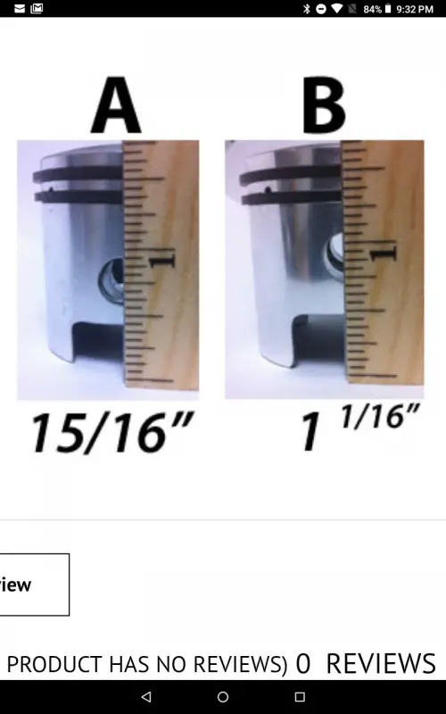

Pick up a piston and ring set with gaskets. Aside from the proper diameter piston you need to check whether you have a low or high pin piston. Looks to me yours is low but do a reality check.

Get the Cabor rings or any rings for a 47x1.5 mm... HL supply...

Im having trouble figure out if my piston should be a low or high pin Ive ordered two and they must be wrong any way of knowing without tools to measure it?
