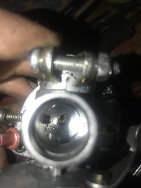

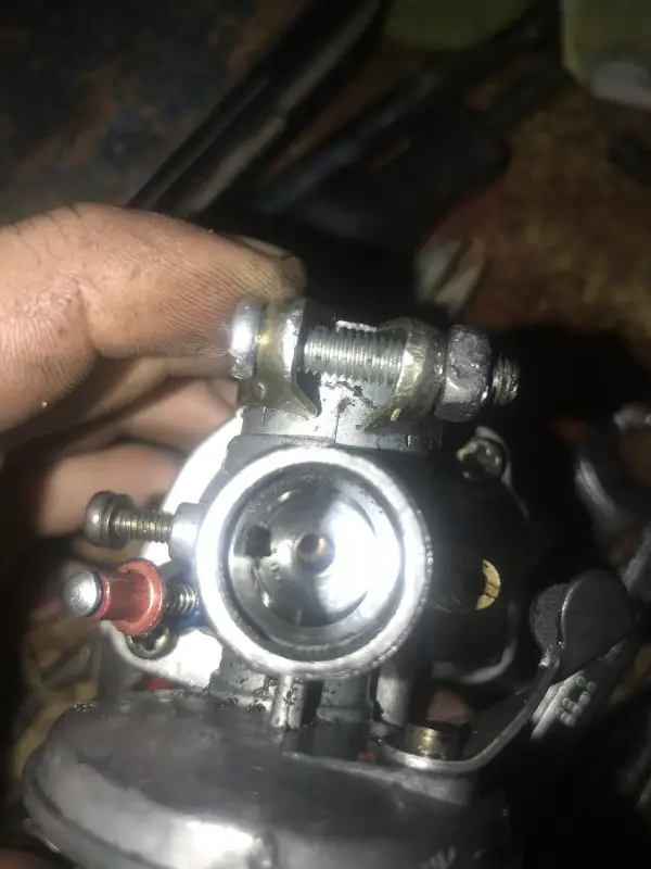

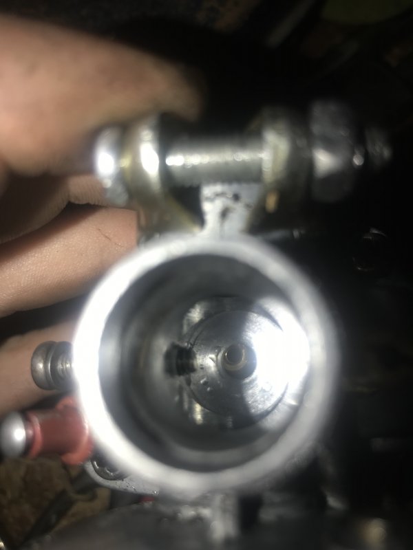

the jet is loose, and off centred , i took the carb apart so, I’m not sure if that’s there because I took apart the carb, or it’s been loose the whole time.

To much oil in you're gas, dump some from tank and line, add more gas......I use 50/50 mix synthetic car oil and vegetable oil

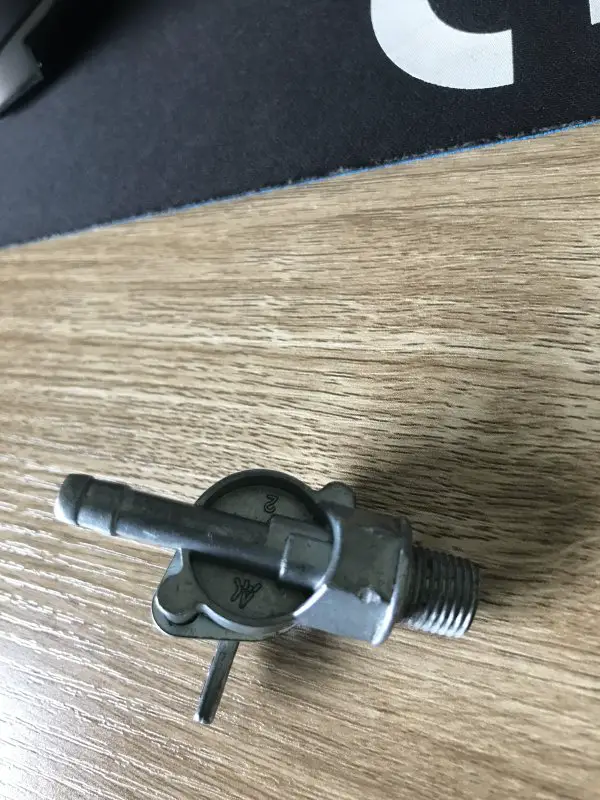

There’s a metal strainer that is supposed to be a filter, if you have a in-line filter you can remove it.
Most petcocks have a reserve like motorcycles do, there should be two openings on the petcock with one tube taller than the other.
