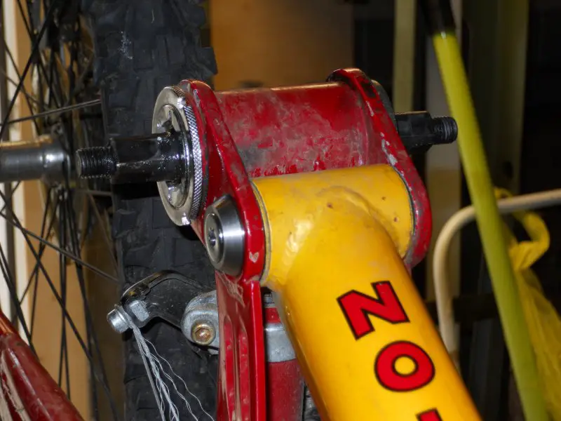

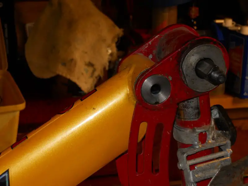

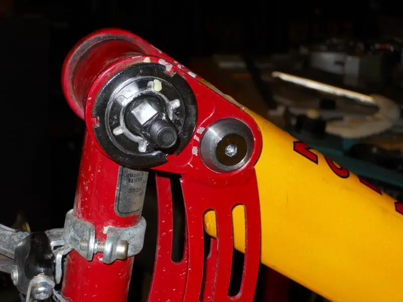

Photos of the rear suspension joint Assy made by Peterson Precision. The left side cap washer needed a 1mm recess step to get the rear suspension to move freely when all was drawn up. The bike is hanging down side up.
