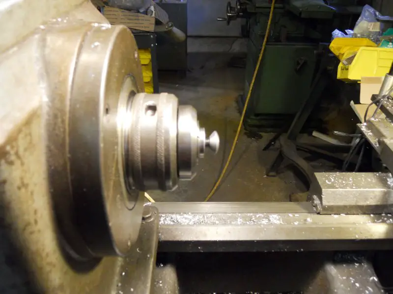

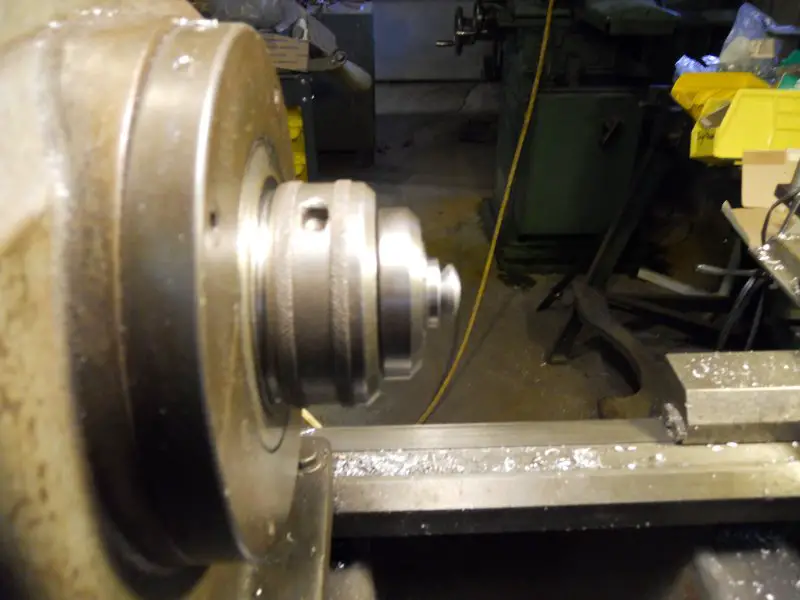

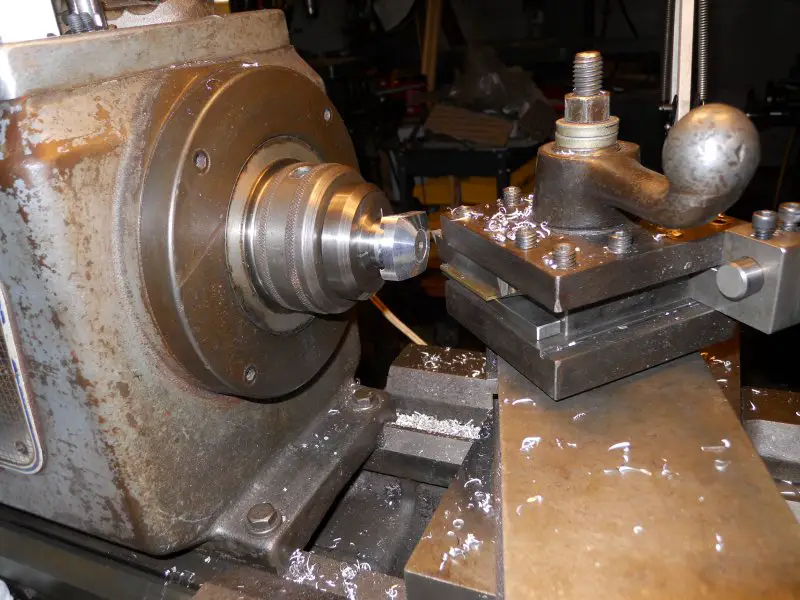

The 18 degree contour and corner radius are done.
Milled off some from the longitudinal end. How much?
I don't know, but it surely changed the clamping surface by 20% and will not affect the design requirements.
Photos of the two lathe operations.

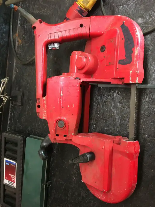

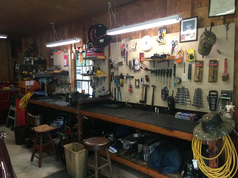

I don’t have anywhere near what several have posted here but did pick up a Milwaukee porta-band free from a friend of mine, I tried to pay for it but he wouldn’t have it, so I told him to loan it to me and if he ever needs it I’ll bring it back.

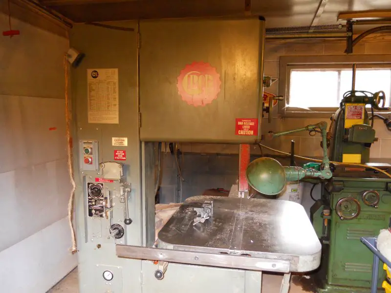

Anyway, out in the shop today turning a nut to mate into a 82degree countersink. Went to part it off on the Grob bandsaw blade no good. Will have to weld up a fresh one tomorrow.

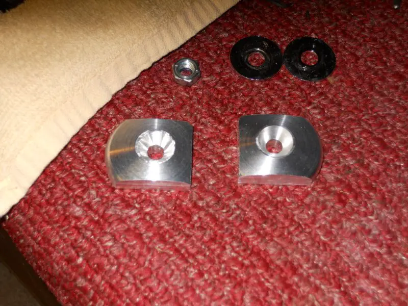

External seat clamps done. Three inch 5/16-18 flat head cap screw ordered. As a onesie $1.92+ $7.50 shipping and handling, but thirty dollars of screws I would never use. Bargain.
Made a nut to draw the whole assembly together from some 0-1 bar stock threaded 5/16-18, tapered 82 degrees combined to match the clamp countersinks. Was ready to part it off on my bandsaw, but the blade in it was shot.
This is a task I try to avoid but know will result in another perfect blade. I buy 100ft spools of Starrett blade stock.
Cut to 150" lengths. Grob bandsaws have the best butt resistance welder I have ever used in my fifty years in my trade bar non. Weld dressed up with a Dremel as my Bandsaw does not have the optional grinder built in.
No matter, blade weld cleaned up after anneal.

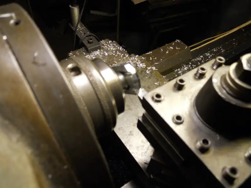

Parting done, back on the 5/16-18 threaded mandrel to profile the out side face, sort of a blended radius from various angles as I only have one suitable radius cutter for the Logan Lathe.
