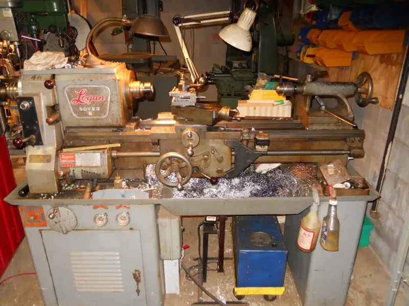

Currently machining a new 14 tooth #35 sprocket for my Sportsman Flyer. With my Logan lathe just because I can.

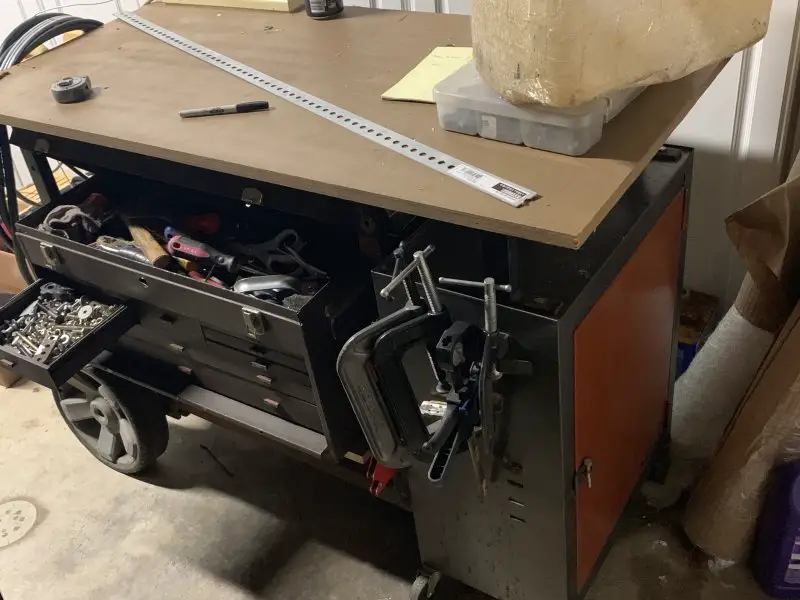

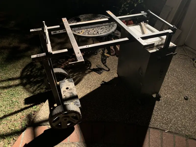

I just built this tool cart work table from scrap that was taking up space. It has most stuff needed for bike size fab within reach. I was having this problem where every time I worked on stuff, I had to spend an hour or more just moving and setting up tools. The idea with this cart is to have just what is needed for 95% of stuff I will do at home, within at most 10 seconds of reach.
Table 3/4” plywood 48x22 probably gonna cut it down to 20”. 1.25Dia handles front and back. (Front one hanging on rear handle in first pic). Welder controls at back, wire door opens to side. Drawers with bagged and special parts forward of that. 26” Kennedy box on right. Reorganized the toolbox from machinist oriented to fab oriented; took a lot of old machined parts out of it and gained space for a drawer full of inch high strength and stainless hardware. 3 sizes mostly so building something up can go smoothly and without looking for parts which as you all know ALWAYS takes forever. Maintained the box, greased the old slides, straightened the lid. Reduced two drawers of measuring tools to one keeping my .007” Fowled-er scribing caliper on top for fab. I think an automotive intermediate box would be a good replacement for the kennedy. I may do that if the Kennedy moves into a shop again. The lid stays up under the table with two small magnets. The entire cart sort of fifth wheels on a crappy little ~19” rollaway cabinet.
All the wheels are loaded at well over their rated capacity, even got some serious camber in the back so I moved some heft to the front. It really needs to get some stronger wheels, and hang onto a real toolbox :D but for now hasn’t cost me a dime, just 5 hours of my life I probably woulda spent a few times over just moving and looking for tools. It’s gonna get outlets soon, switched ones too. I just wanna plug in two plugs and go do my thing outside, then bring it all back in real quick all setup for the next window of time to work on stuff. Might even sink a wireless charger into the table but for now have that one at my bedside, and the work table gets the iPad brick to supercharge a 3ah phone 50% in under 45 min. Not really good to have the phone exposed to mechanical work so I may figure a charging tray under the table. Overall I am happy with how it turned out.

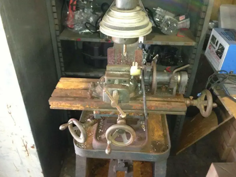

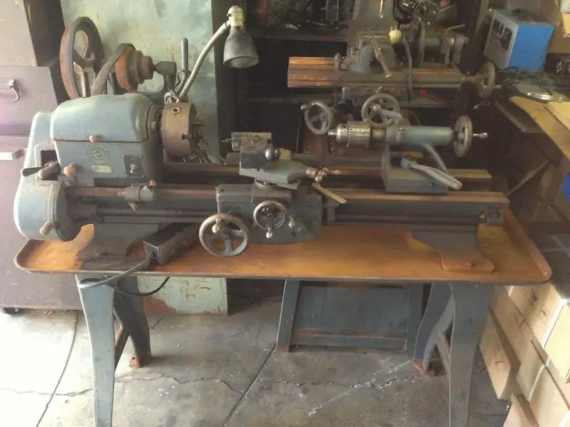

Here's my old lathe & mini mill that I bought from a friend when his father died... (this is what they looked like the day I brought them home).
They both needed a little cleaning up, but they both still work great & I also have several boxes of bits, replacement parts, & specialty tools for them for making special parts.

Your lathe has a lot of parts to make left in it....
