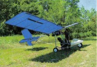

Would it confuse things to mention that I, as well as a coupla other members are/were "ultralight guys"? :D
My flying lawnchair had an (inverted) Rotax 440 & I ran it @ 32:1 w/a nonsynthetic BTW
It's a Quicksivler MX ;)

....droooool.....
I do a lot of reckless stuff & give myself about a 50% chance of ending up in a wheelchair. If it has to happen, crashing a machine I built & taught myself to fly would probably be my choice. Tip o' the hat, sirs. Gray matter & brass combined.
