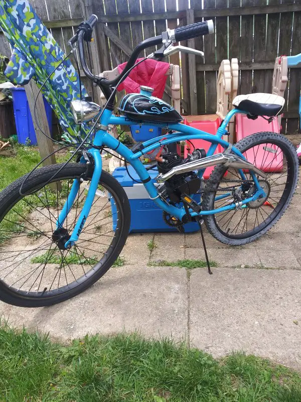

I got a custom made seat post from member inked1974. He fabbed it to my preferred layback angle outa solid stock. Don't remember the price, but I do remember thinking that it was a helluva deal!
  • Like
Reactions: Dan
Cool, Xman. Any pics?
