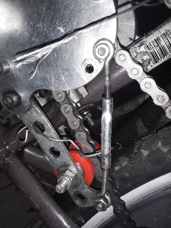

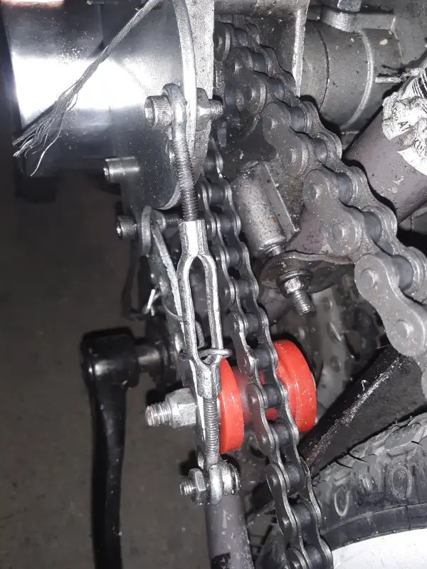

The spring loaded tensioner i found is bullshit,i just went through my phase with the spring and man that chain would bind up at the drive sprocket because of the spring......so what i did ro stop that problem is got rid of the spring and added a small turn buckle .....so the tensioner is stationary, oh and i got some cheap ass skate board wheel for the pully and i tell you what skateboard wheels should stay with skating, other word they're too bulky and too soft and so i made my own with 2 large washers and 2 skateberings sandwhiched in between i'l show some pictures you can barley see the tensoner but you can see the turnbuckle

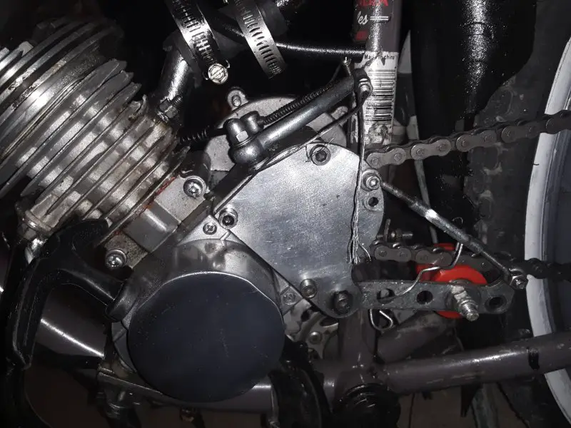

I've tried without the tensioner for a while but the sprockets that i baught are not round every one of them is ofset just a little and the chain kept poping off with out the tensonee now all that action happened when i WAS using spoked rims and spokes bend from the torque of the motor pulling mainly from starting the bike the sudden high torque applied to the back rim .....so i use the tensioner but no spring a turnbuckle instead and it is adjustable .....so far soooooo good on my drive train,ill try to post abetter picture..... wait one..... over
The wire is there to stop the turnbuckle from twisting

Last i got mags so the spoke episodes are put to rest for now and .........update i got the alu pull starter i polished and mounted it this morning works great less strain starting no pedaling required until takeoff its a little hard on the clutch from stop but the taller sprocket helps big im on the 48tooth now but the 56t has no problem pulling out of the hole even with a loaded trailre and all this i with the tensoner gotta have it.....
