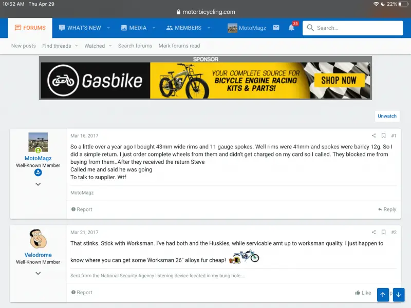

Here is a snap shot.. If this was taken care of buy Joe or who ever then you would not be seeing this. I was going to give you another shot and get some regular bicycle wheels...no I’m blocked from buying.I wish I had the Bs emails.

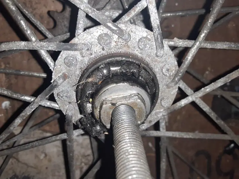

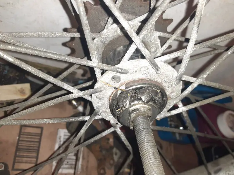

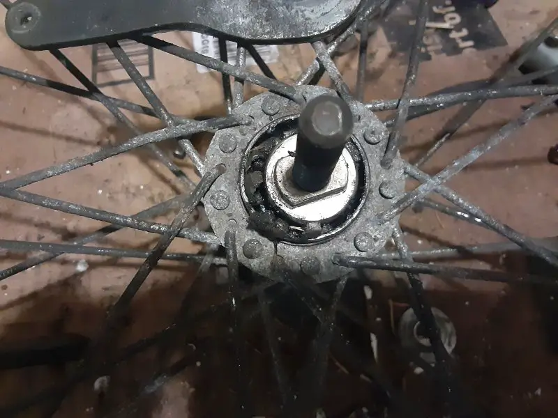

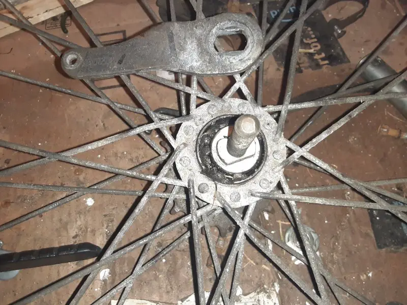

gill vanderwerf, it would benefit us all to have clear concise photos of not only your rear wheel application, but clear concise photos of the hub failures and the circumstances in which they occurred.
here are the pics

Well Gil, you have shown us the ugliest wheel hubs of a bike I have ever witnessed. Care to show us the frame the wheels were mounted on?

I almost had a hub failure. Pat of Sportsman Flyer warned me that a poorly secured brake arm would twist. Mine did.
In so doing the twisted brake arm unlocked the bearing cones. It took many miles to cause an unstable rear wheel. Squirrelly. The wheel had undone itself. Got home and gave the rear wheel a test for movement. At the tire a 3/8" side to side movement.
I still have that brake arm.
To replace the twisted brake arm, only came with a full coaster brake internals. For a rainy day if needs be.
In order to keep the replacement brake arm from twisting I fashioned a 1.5mm thick X 19mm strap which works.

Curt, did you take a hard at the photos Gil posted? They look like chit.
You are most likely right about improper cone adjustment. Danny and I both order the same sets of wheels.
I was a Schwinn mechanic during my High School years. I never saw a wheel hub like Gil's.
