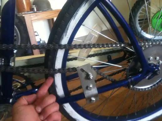

    I have ridden my bike every afternoon for the last few days. So happy everything is staying together. My idle seemed to work great once I turned the idle screw. But now I'm noticing that my engine sounds like its about to die if im not giving any throttle, AND i'm in gear. Once I pull the clutch lever, it idles nicely. Is there something I can adjust for this?
    And what is the purpose of the choke?
    The last issue I am running into is chain clearance, hitting my rear tire. Im gonna have to do some research on this to figure it out. It clears fine in the garage, but I see black marks on the tire after I ride.

  5. IreBo
    IreBo New Member
    Joined:
    Jul 22, 2011
    Messages:
    156
    Likes Received:
    Yo Donkey, sounds like youre bike is doing well.... so about the choke. i rarely use mine. only if its really cold and/ or i havnt ran my motor in a while. if i do use it for a cold start i cloes the choke, bump start the bike ,and as soon as it starts i flip it open. i will also use it as a speed limiter for nwebies or youngsters that want to try out my bike. ill close it a bit while riding full throttle until it just starts to slow down. basiclly a rev limiter. other than that dont pay much attention to it ide say.
    so the idle with it in gear thing, well its like driving a stick shift car. you cant just let the clutch out while in first and expect it to drive smoothly. you need to feather the clutch with some throttle and when you are going you can dump the clutch. its not an auto! lol..
    dont be afraid to slip the hel out of that clutch. they last a while, have alot of adjustment before they are toast and the pads are cheap and one of the easiest things to service.. you can convert it if you want. they have a kit. looks lame tho.

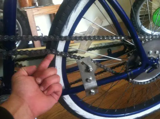

    ok so the tire has some angled black scuffs from the chain?? thats pretty normal imo.. as long as they are just marks and not gouges. that chain moves all over the place and when off throttle in coast with the engine enguaged the loose side of the chain flops all over. its ok if its not wearing into the tire. just marks are ok and you will need special parts to fix that like offset motor mounts. if you just move the rear sprocket you are just puting it out of alignment. you will have to move the motor also. you can tey to tighten the chain a bit with the tensioner. that may help

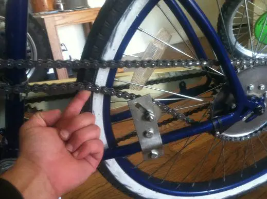

  6. IreBo
    IreBo New Member
    Joined:
    Jul 22, 2011
    Messages:
    156
    Likes Received:
    see the marks on mine? id doesnt rub all the time , but the chain flops around some so i think its almost unavoidable in less you run it with a spring tensioner or none at all and run the chain a bit tight but that may not work out that well.

    Many Cranny people I have talked to agree the rear tire is a skosh too fat for chain interference with the wheel and tensioner. It works, but you hafta hold your mouth just right while centering the wheel and it is a PIA if you don't have a helper to work with you centering the wheel..
    Mounting the next narrower size tire 1.95 instead of 2.25" (I think ) solves the problem, works fine , rides fine, appears little different
