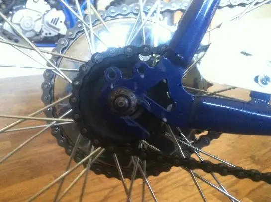

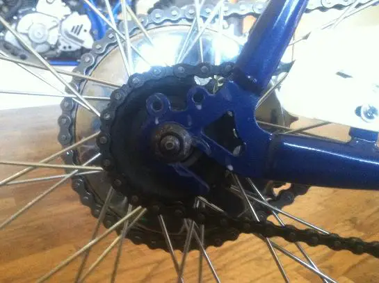

As for the rear sprocket, my biggest concern is chain clearance. The way I have it setup now, the chain actually clears the frame and tire pretty well. But, according to others, I have the sprocket on wrong. So...my question is if I throw one of the rubber stoppers back onto the other side of the spokes, I lose not only my coaster brake, but my chain clearance as well. AHHH! Can someone enlighten me on this??
The other thing is my chain seems too long. As you can kind of see from this pic, its sitting very low. Even when I just placed the tensioner on the bike with my hand, it seems too long. The bottom part of the chain hits the top part before its anywhere near tight enough. Are people shortenging their chain?? And if I do shorten it, can I just make it the correct length and not worry about the tensioner?

Anyways, I will post some pics here tonight...I fixed the chain by taking out 2 links. It helped a lot but I still need the tensioner.
My problem right now is my chain tensioner keeps moving into my spokes right when I release the clutch to start the engine. I think I may try to put a bolt through the tensioner and through the frame to secure it, but can't figure out why this is happening!!! The chain is basically coming off of the rear sprocket and pulling the tensioner into the wheel.

as for the chain tensioner moveing it just sounds like you need to tighten the two mounting bolts tighter. i had to tighten the one on my Trek so tight that it bent the week stock hardware and i replaced them with grade 8 bolts and nuts, then just cranked them down as hard as i could. i would deffinetly do that before drilling that part of the frame.. as we have pointed out the huffy frame is thin and it may form a crack or plain snap.??
are you shure that you have everything lined up?? get down behind the sproket and sight the chain from rear sprocket to the front one get them lined up as well as you can. that and tighten up the guide and you should be fine.

badboy, if you look at the earlier pics in this thred you will see some i posted. if you have the dish facing inwards, teeth closer to the wheele, then you need to flip it, we had a bit of a discussion earlier, just back track.... ide say flip the sproket

Yes I now realise this. Turns out my back tire was slightly misaligned, causing the sprocket to slowly pull the chain off of alignment, but at a higher speed, it happened very quickly.
My note on chain tensioners: ****em. The stock one sucks. I tried everything to get it to work, including using a skateboard tire. Finally I just wised up and removed a few more links from my chain. So much better. I adjust the tension by moving the back tire where it needs to be. I rather tension the bike chain anyways since its way less important. But haven't had to do that yet.
