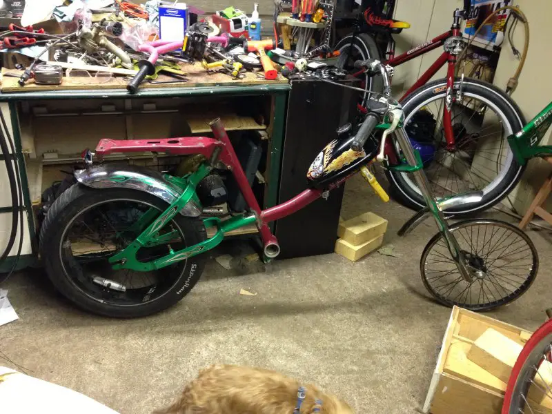

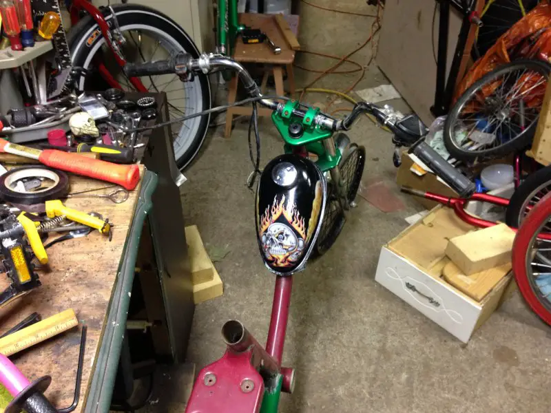

Some of what I show here is my thought process so I can chew over what I am building. As it moves forward it will change a little here and there, but the basic idea is set and flowing.

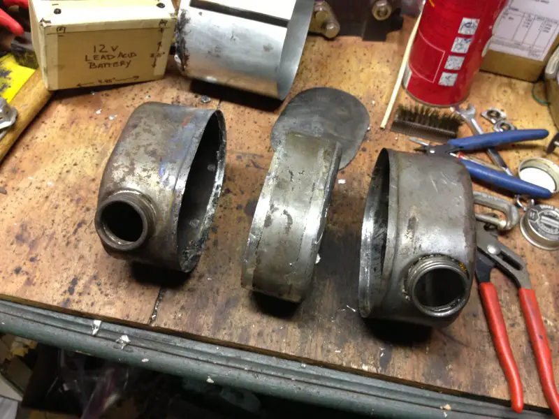

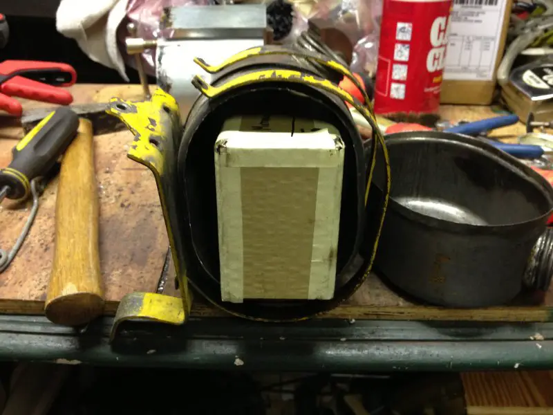

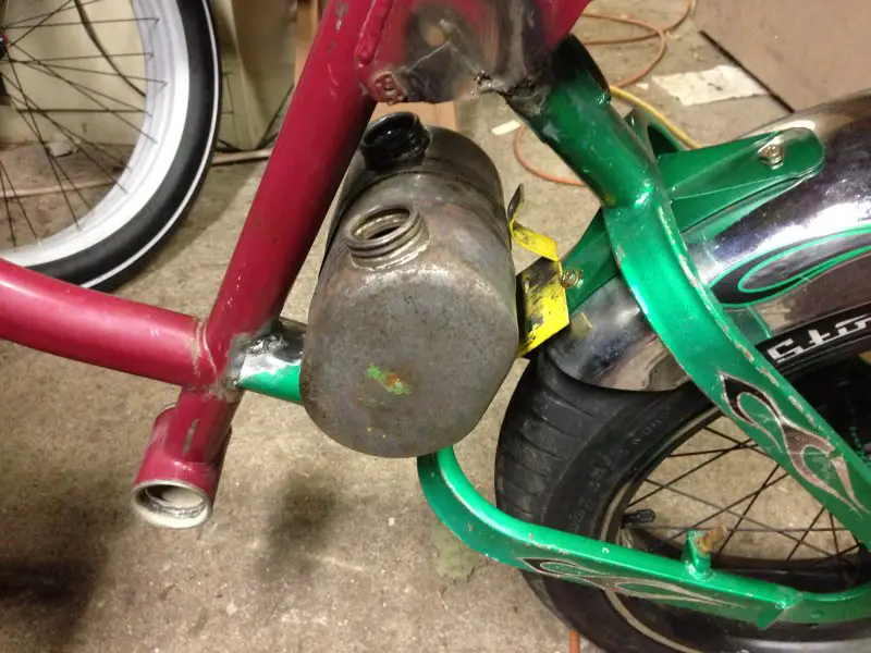

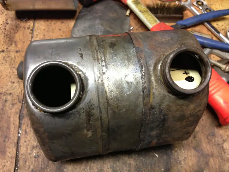

OK, so I took apart a gas tank from an old chain saw to make a battery box for my AMF. This tank had two sides to it, as one was for the bar oil I think and the other was for the gas. At first I was going to solder in a new center section but I was able to get a good bond so I just cut out the end in the original center section and will use it that way.
Now all I have to do is solder two of the section together and create a latch for the third section and mount it to the frame.
I like what you're doing on this thing, gonna be a nice ride when your done..... great idea on the battery box.

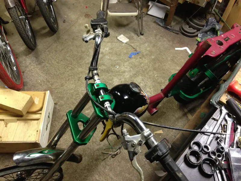

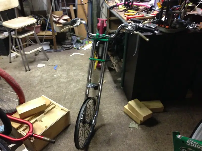

I was not planning on it but I may in the end. How hard would it be to convert the forks that is going on there now? They are from an OCC chopper. Could the tubes be replaced with suspension tubes?
You could build a springer fork set up out of them, the welding would ruin the chrome and would require that you paint them so they would look good but a springer fork could be fab'd up pretty easy actually.
Here is something that is crude but I just marked up in word program.
maybe this will give you some ideas and maybe it's nothing you haven't already thought of, but here it is just the same.
Peace, Map
Suzuki K-10 forks will fit and are awesome forks, but the legs are wide enough apart that you would need to come up with a longer axle for the Worksman wheel. A hassle for sure. Something from a moped will work nicely and your axle on the Worksman would be fine. Something like a Puch or Tomos would work. A nice thing about a triple tree fork is that it extends the front wheel several more inches, essentially stretching the frame some.
