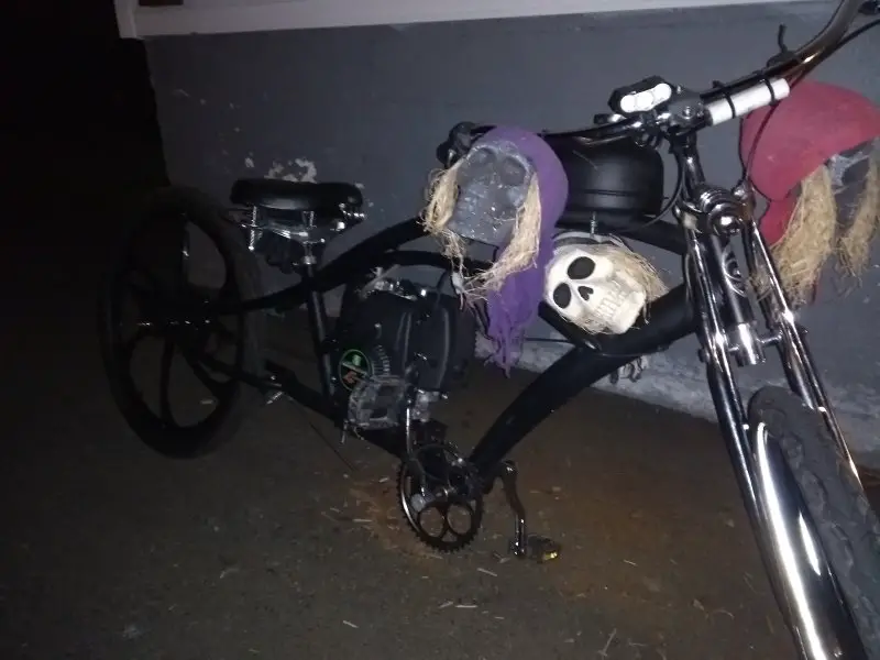

Here's a picture of my bike:

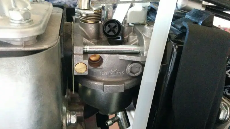

I have the HuaSheng 142F (49cc) motor. From recommendations from another forum I was told that there is a A/F adjustment screw hidden behind the brass plug on the other side of the carburetor. Pictured here:
(A/F adjustment screw behind the brass plug closest the the engine)
He stated "Lean engines burn cleaner, but too lean = no fire. I prefer slightly on the rich side, engine runs cooler."
He said if I took out the plug, I would be able to tune the motor.
Would this be the miracule cure to make the motor start?

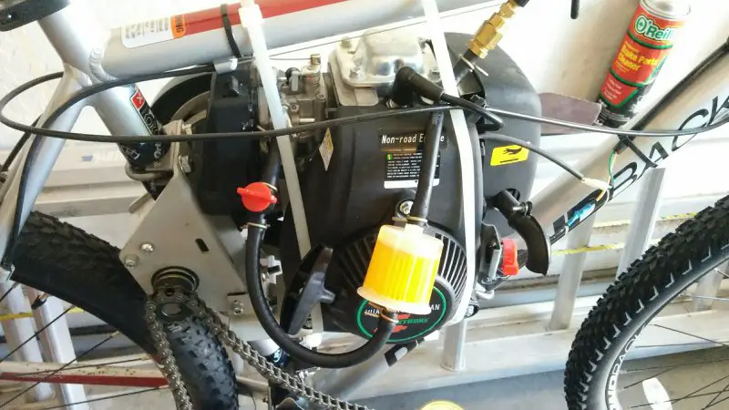

The V-mount HS carbs unlike their rack mount brothers, have no fuel pump. If your tank is almost empty it doesn't have the weight to push all the fuel up to the carb from that huge fuel filter below the carb.
I suggest you loose that filter and use a smaller one, and keep all gas ABOVE the carb.
img_20180315_160938-jpg.97961
Its hard to see the result of a project that may have been over the builders mechanical skill level.

I have the HuaSheng 142F (49cc) motor. From recommendations from another forum I was told that there is a A/F adjustment screw hidden behind the brass plug on the other side of the carburetor. Pictured here: View attachment 97962

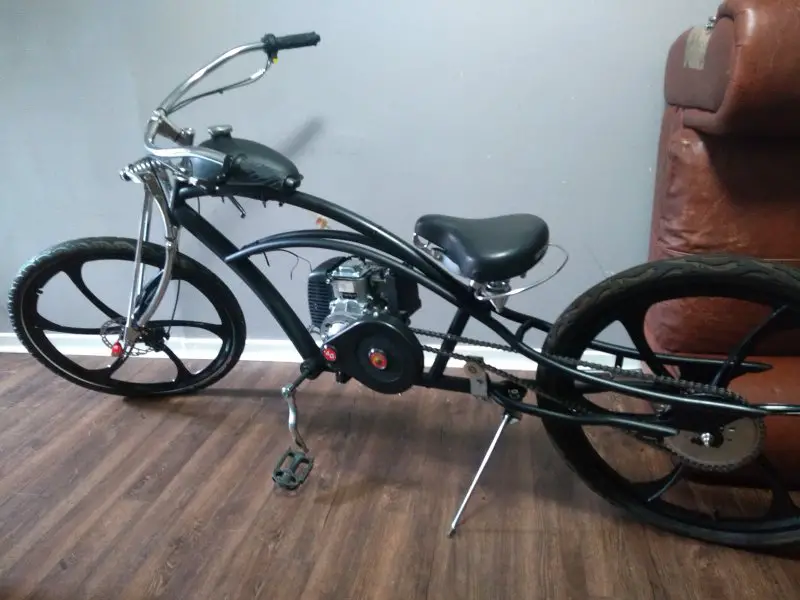

I have this on the go, 49cc huasheng 4 stroke, it's a marcargi bicycle .
question I'm getting at is , if I remove that plug and get at the air/fuel mix screw will this give me more top end/speed I only gets 40k almost 30mph which I think is slow for this motor, idk? I hear it should do around 35mph or more, it seems to bog down in top end ...is like she wants go more but not getting it, would this hidden screw help with this problem, I don't have any other issues other than too GD slow...lol
thanks everyone and greatly appreciate any info I can get.

As I have done that recently, the easy answer is yes, adjust that screw will make a HUGE difference. I had the same issue, I could feel that the engine wanted to go more, adjusted that and instant improvement. As for the top speed, that will depend on the gearing you are using, easiest to change would be the rear sprocket. Finally, my engine kit came with the "basic" muffler, this one: https://www.gasbike.net/collections/mufflers/products/chrome-exhaust-muffler-1 , not sure how much it would affect performance.
