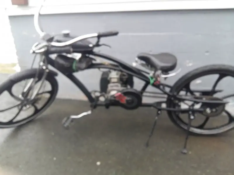

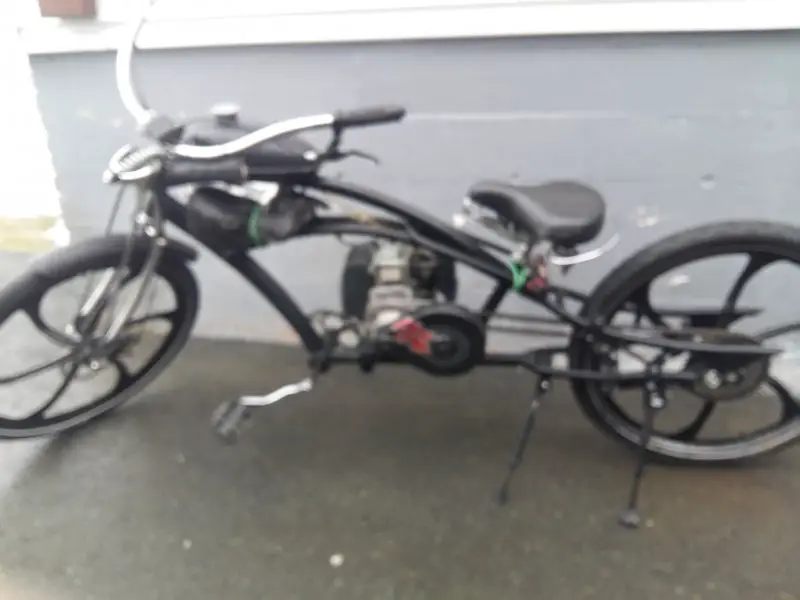

this is what i have otg...micargi stretch beacb cruiser ..mustang and puma...only two here in newfounldand possibly in all of eastern canada..luvs my american made bike..wish you guys get back to making product again. .but anywsy will it do harm to yhe engine by running a 2 stroke.

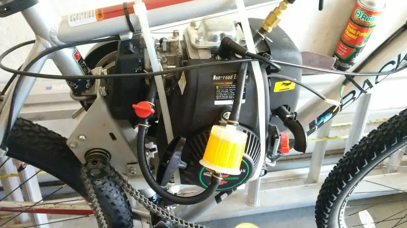

Here's a picture of my bike: View attachment 97961

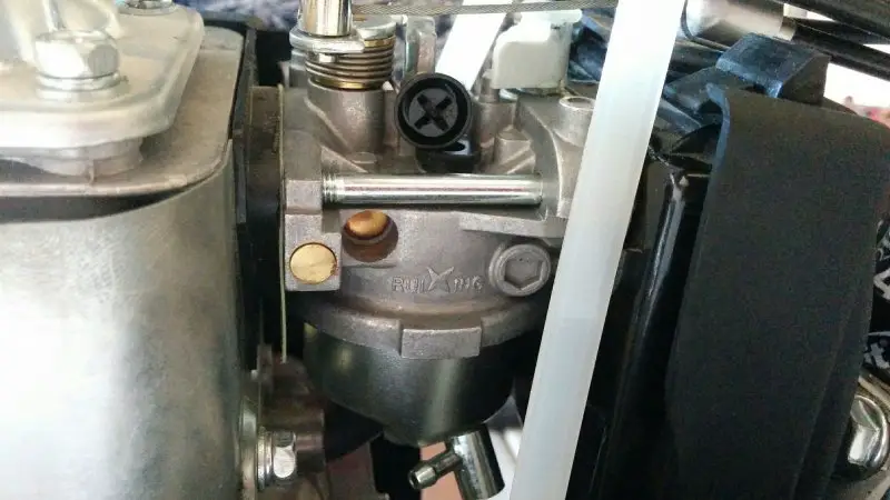

I have the HuaSheng 142F (49cc) motor. From recommendations from another forum I was told that there is a A/F adjustment screw hidden behind the brass plug on the other side of the carburetor. Pictured here: View attachment 97962
(A/F adjustment screw behind the brass plug closest the the engine)
He stated "Lean engines burn cleaner, but too lean = no fire. I prefer slightly on the rich side, engine runs cooler."
He said if I took out the plug, I would be able to tune the motor.
Would this be the miracule cure to make the motor start?
drill it ..go slow..mine came right out no probs...but i have to say it hasnt done much at all...the company that i bought mine fro. said i my have to gey another carb...older model tbey said...i guess one with air/fuel mix...im going to try this adaptor thing so you can put on 2 strike carbs...BikeBerry and kings motor bikes has them i know ..im going to give a whirl ,see what happens...it works out I'll let you all know. ..this is what i have otg.
making sidecar now for it..haul dog around..lol

"Adjusting the HuaSheng 142F (49cc) carburetor
In order to adjust the carburetor it is necessary to warm the motor up first. The motor should have at least 5 minutes running time before any adjustments are made.
On the left side of the carburetor near the front is the idle mixture screw.
On the HuaSheng motor the idle mixture screw is a fuel adjustment, not an air adjustment.
Simply adjust the screw for maximum idle, and then turn the screw approx 1/16" counter-clockwise [slightly rich].
Check the throttle response, and adjust the mixture if there is a hesitation. Turn screw clockwise if it "bulks" and then catches on [rich], or adjust screw counter-clockwise if it accelerates and then drops off quickly [lean].
Have fun,
Quenton "Lee" Guenther
EZ Motorbike Company
www.ezmotorbike.com"
