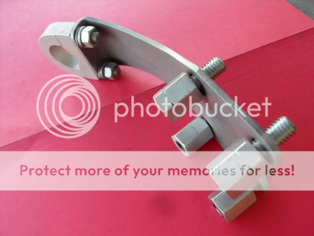

    You can also triangulate your install with a head brace. I made this cool bracket for a motor I was having vibration problems with. It went right onto the cylinder studs and reached forward to clamp onto the front tubing. I ended up balancing the motor and not using the clamp, but it's always an option.
    [​IMG]
