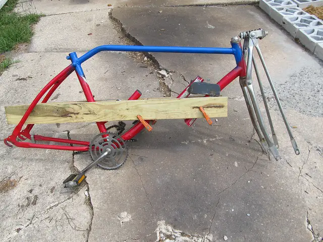

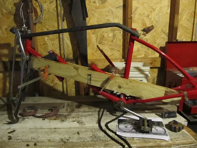

After cutting the frame in two I welded a couple of plates to the front half's tubes so I'd know they were square, then cut the bit of top tube out of the way so I could fit in a new one. Then I clamped both halves between bits of 1x4 and shimmed both sides with a couple of small wrenches for shims to fine tune it. This method of keeping it all square worked better than I expected.
New top tube welded in place with splints still holding bottom together.

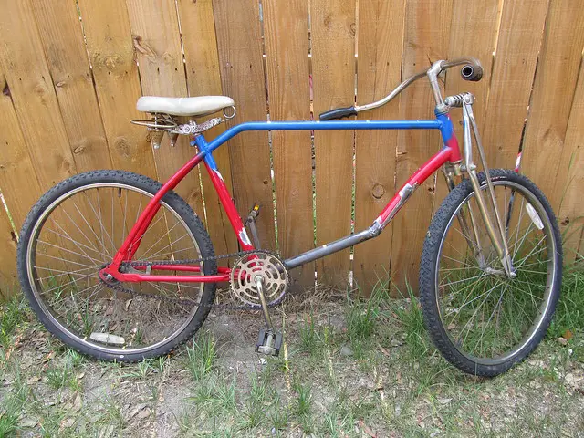

After getting the frame back in once piece, I tossed it together for a spin around the block. Not too bad.

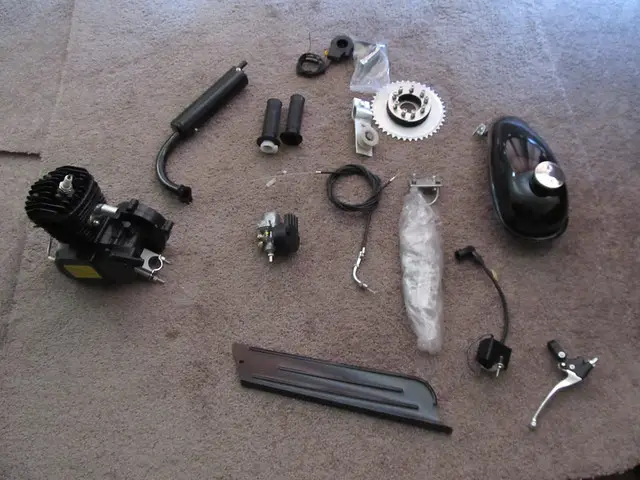

After about 10min of putting bits together from the box. I was surprised how much was left unassembled.

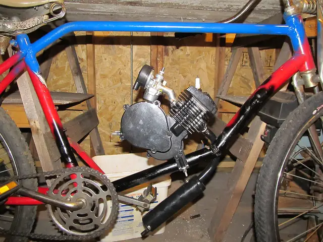

Motor rough fit
I'm not sure I'm happy with the straight addition to the down tube since it makes the motor seem to ride a little high for the middle tube to clear the spark plug and throttle cable. This is my first build of this kind, so if anyone has any good advice I'm all ears.

Your top tube is looking real good, but you need to redo a whole new downtube imo, this will lower the motor which will help with handling and also help you level that motor out so your carby is horizontal..... are you going to mount a fuel tank inside the frame?

Agreed. The more I look at the downtube the less I like it. Having that weld in the middle and no curve to part of it kinda kills the aesthetics even if the carb would work at that angle. Any idea how to bend tubing into a curve or where to snag a donor? The top tube came from a handle on a broken down hand truck I had around. I tried making a press with a 1/4" steel plate, some galvanized pipe, and a bottle jack, but the plate bows before the tubing bends. :(
I am gonna fab up and mount a tank inside the frame, which I guess gives me all the more reason to find a more suitable down tube.

Ask shops for scraps, try metal recyclig yards. And last resort buy a length of new tube. And have a look on here for down tubes you like, they can either curve and follow the front wheel or come straight down and have a drop loop on the bottom. If you arent confident bending the downtube try a mendrell bending place for a quote or get some scrap and practice

Well, I've made my peace with the top down tube not having a curve to it, and have mounted my rear sprocket and made up a motor mount for the rear mount. I'm still not sure I'm happy with the peanut gas tank, but it's at least decently matching to the bike as it is now. Just need to mount everything up tight, get the cables, hoses, and chain straight, and I'll give it a whirl before getting ready for paint.

What Silverbear said..... plus if you are going to run the motor at that angle, you may need to level your carby so its vertical. Otherwise good work and enjoy the thing. They are so much fun....

How do you level the carb if the motors at an angle? Is there a differently angled intake manifold? Does it matter if it seems to be running alright as-is.

If it were me, id remove your motor, cut off your rear engine mount and remount the engine. You could mount the motor directly to your seat tube and make and your engine mount for the downtube. That would get the motor where it should be and carby level.
If you dont feel like doing that you could modify your inlet manifold, or make a new one. Im not sure if they sell them. But resetting the motor would be easier IMO.

I'll definitely keep those things in mind, but like I said, there doesn't seem to be much issue with the carb being at the angle it's at right now. If anyone knows of a problem it might pose that I'm not noticing I'll definitely remedy it though.

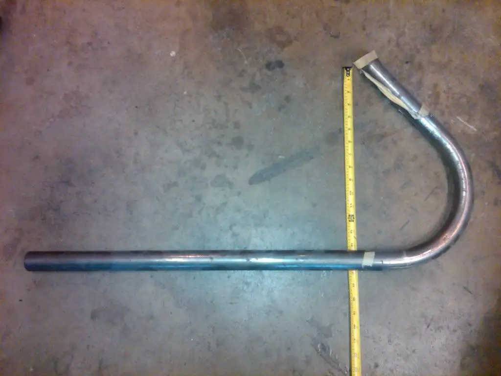

Hello, nice effort! Motorbikes are great. I agree about the down tube. Here is what I did:
When I built my 1911 Indian I made two down tubes so I could use one as a pattern for myself for a second bike if I ever did one. Go to a steel fabrication shop or somewhere that has a "radius bender". Show them this picture. The measuring tape shows 14 1/2" from inside to inside, and the long end is about 3 feet long. Cut off your down tube, cut some of the "J" off, and weld it on your crank bracket from the bottom so the "U" is like the Letter "U". On the long strait part you will need to do a small bend right where the front tire gets closest to the tube, and weld onto your steering bracket. You will now have a vintage "drop loop" frame. You nailed the top tube perfectly! Then if you get the urge, you could lengthen the rear triangle a couple of inches to elongate the entire wheelbase. Good job so far!

Thanks for the input cobra. Since these motors are a little on the small side compared with their 1920s brethren I'm a not so in favor of the drop loop but when the time comes I'd definitely be looking for someone with a radius bender. I have seen some with mounting plates filling some of the area under the motor which looked pretty nice though. I tried an electrical conduit bender at first, but it just kinked the tubing. Getting a nice swooping curve otherwise seems to be an exercise in madness :p.
The frame is already stretched by about 6 inches, so using another ladies bike frame for the down tube seems out of the question unless I butt two of them together and take what I need from that.
