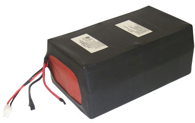

I was looking for it because if the weight factor. I think my pack weighs roughly 28lbs for a 48v 30ah battery. At first I was going to get the ion but didn't like that it only could get around 800 charges and the biggest I could find was a 12ah one.

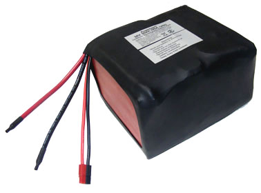

My AllCell Lithium Nickel 48V 12.9Ah weighs 9 Lbs. but is limited to 20A max drain rate, as are all their models. No more AllCell for me, even though it's a great pack other than that. I'm done with them. LOL
