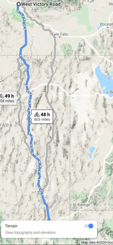

I do plan on using this bike several times to go to las vegas via ID-51 / NV-225. It seems like the grade in several spots exceeds 30%. These are going to really cut down my range, especially considering I intend to tow a very carefully selected trailer, loaded with no more than 20lbs of clothes and 15lbs of extra fuel (about 2.5 gallons). The downhill sides are going to be super fun, but the uphill sides, I will probably have to stop every now and then to let my engine cool off. I do also plan on putting a 42-11 cassette on the bike, with that 28t chainring. I won't have any issues at all climbing any mountain with that. It's a very similar gearing to my mountain bike.
This is the route I plan on taking to vegas.

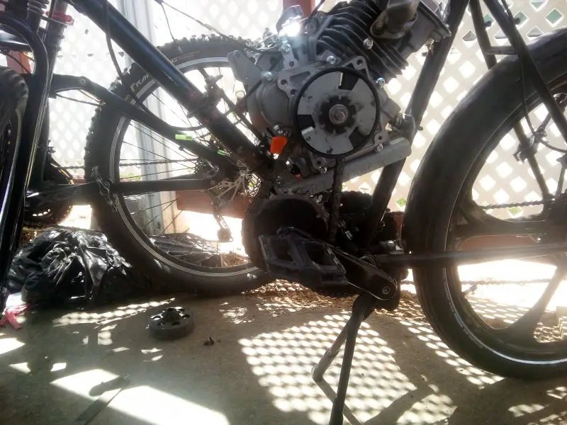

Yeah, that 30t is pretty heavy, an easy 5lbs. I'm going to look at SBP for options. I have both #420 and #40 power transfer chains available for use, so I don't have to worry quite as much about what the sprocket needs, so long as it's not #35. I'm not too worried about that 30t being a chainsaw, if that #40 chain breaks, that gear is going to simply stop turning, and it's actually closer to my ankle than anything else. I can use my shoe to stop that gear if the chain breaks, and then the freehub takes over. I'm literally far more worried about throwing a rod or breaking my flywheel than I am about being shredded by gears. I've also got those teeth tapered to the inside (god bless bench grinders), so even IF that gear keeps turning after being disconnected, I won't suffer serious injury from it.
I have also requested a quote for having a flywheel and rod machined at a precision CNC company here in Boise, but they have not responded yet. I'm going to message a few more precision CNC companies.
It's not if the chain breaks.
It's if the chain DOESN'T break at 6,000rpm. Your 30t sprocket will be spinning like a 2,000 rpm chainsaw blade, if you have an accident.
You should think about making chainguards.

I planned on having them scan the stock flywheel and rod and machine lighter duplicates out of billet aluminum. I even offered to disassemble the engine and directly deliver the parts myself.
Even if the sprocket remains connected, those teeth aren't in a position to do damage. They're 3 inches away from my pants leg, and anywhere my foot or leg would come close to taking damage is covered by the chain. Being a mountain biker as well, I've conditioned myself to drop the pedal on the outside of the lean, which means that the raised pedal will act as a crashguard. I also extend my inside leg so it doesn't get trapped.
