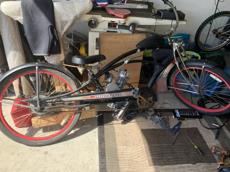

Was stoked last month when I picked up a stretched beach cruiser with a motor. The engine was seized which I freed up and got running. The piston let go where I chose to purchase a new engine opposed to an entire kit. The GT6 pro racing engine showed up in a damaged box. I contacted them where they said to assemble and let them know if there was any issues from shipping. Out of the box I can not get it running. Here is what I have done.

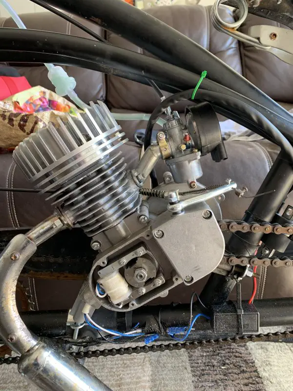

I flipped the magnet to the 11 o’clock position. I get a pop every few pedals or so. The magnet is super lose on the key. I’m contacting the company for a new motor. Can’t see how it will get timed if it’s a guess on where it should be as loose as it is.

I got it running at the 11 o’clock position. Isn’t running as smooth as I thought it would but it’s running. Now to get it to idle.

Just flipped the magnet to 1 and it wouldn’t start. Flipped it back to 11 and it fired right up. About a half turn on the idle adjust and she’s running just fine. The 1 o’clock 11 o’clock really messed with me. I only found 1 video on YouTube that said put it at 11 and another guy said why not try it.

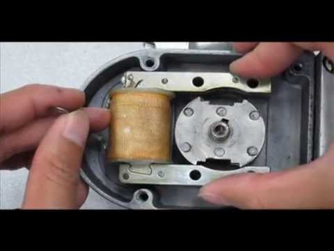

It makes absolutely no sense that it runs with the magnet at 11 o'clock!!
Just so we're on the same page... this is the magnet at 1 o'clock... post a picture of yours.
