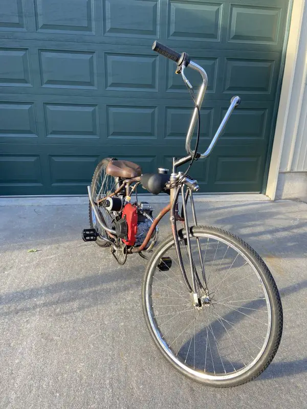

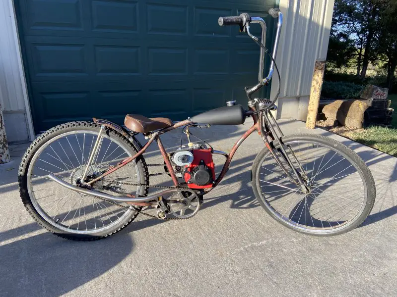

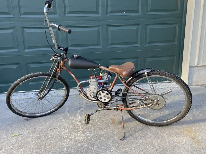

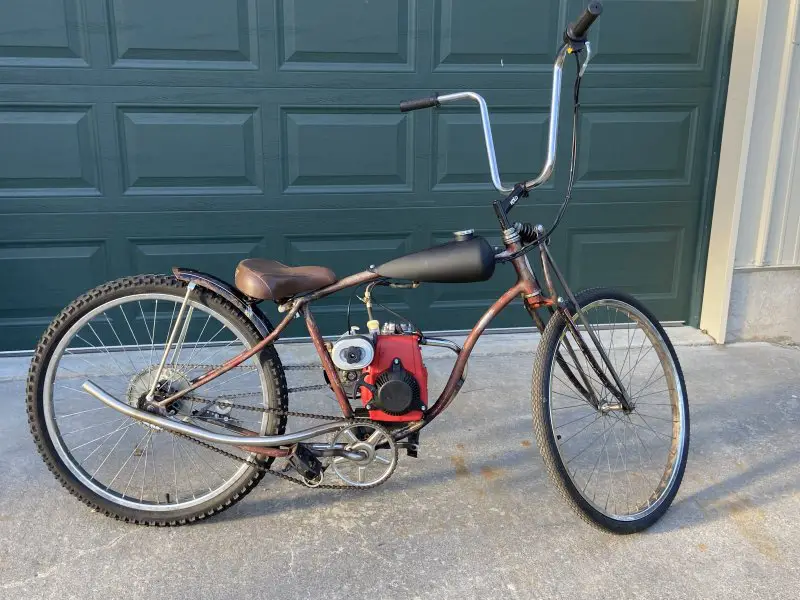

Here is my second build. It started off as a 63 Schwinn American. I cut, chopped, stretched and completely altered until I came up with what I wanted. It has a pre war Schwinn springer front fork and a hand made gas tank I built out of an old fire extinguisher. I decided to add the ape hangers just for a different look. The exhaust pipe is 1” stainless tubing that I bent and adder to the original header. Makes for a nice throaty sound. Actuall rides nice and smooth.

I took the lower bars out below the tank and flipped the upper bars between the seat post and the rear axle. The pre WWII springer fork I installed backwards so that the pivot point was forward a couple inches. It gave me the look I was looking for. Originally I was going to sand it all down and paint it, but I kind of like the “Rat” look and I’m not scared to ride and scratch it .
