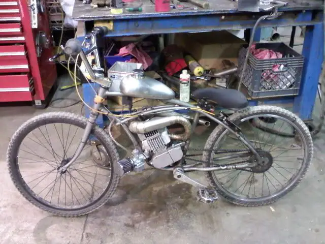

stock puch stroke is 43mm and yours is 40mm, which means that you would either have to shave the bottom of the cylinder or stroke the crank. the wristpin is 12mm on the puch compared to your 10mm, i just tossed the old roller and reamed a bushing out to 12mm. you might be able to buy an intake, you will definitely have to buy a pipe and make it fit. physically mounting the cylinder is the easy part, just drill the stud holes out to 3/8". port matching the transfers is essential. and i'm probably forgetting something

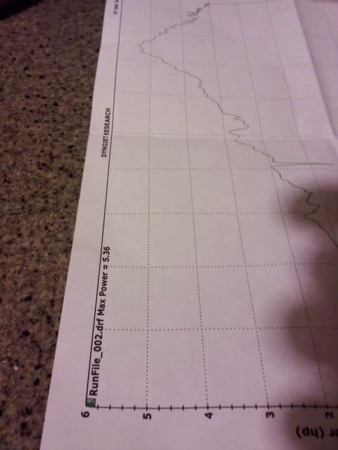

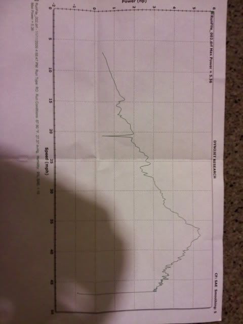

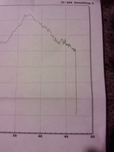

i finally put my little crankenstein experiment on the dyno. i couldn't figure out an easy way to strap it on, so i had to start the bike in the street and ride up on it. getting the inertia wheel spinning smoked my clutch after a few runs and i had to limp it back to the shop. anyways, i got one solid pull and here it is. a little over 5hp at the wheel at 6800rpm. top speed of 47 which works out to almost 8800rpm, i probably could have wrung out 48 but i wasn't being too greedy. definitely not 50mph though. i think i may take a couple inches out of the pipe with another tiny dose of port work for the next expiriment.
