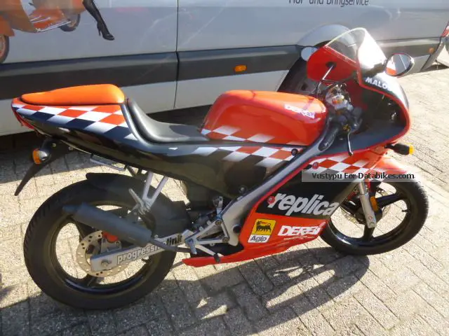

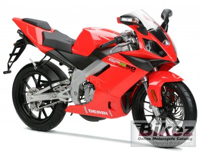

Yeah, it is kinda more like a moped or scooter because I can't figure out how to have 15" wide crank arm spacing without digging in, lol. In Europe you guys get all the good small displacement motorcycles, and I can't afford the headache of an Aprilia or Derbi 50 unfortunately. An upside to this bike is the individual parts are all very affordable so I should be able to afford staying up on maintenance. The stage 2 engine was only $100! :D

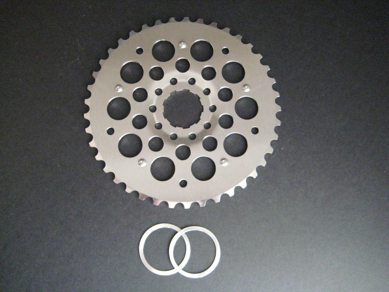

I'm gonna stop kidding myself, and bought this 41 tooth cog for the cassette off Ebay from mtbtools, I heard they kinda suck, but I think if I bolt it into the PG-990 hub it should work better than it has for people not mounting them correctly and bending them, it looks like its tougher than the 34t bottom gear I have currently, lol! I have to drop a top gear to accommodate this, no problem, they're useless.
