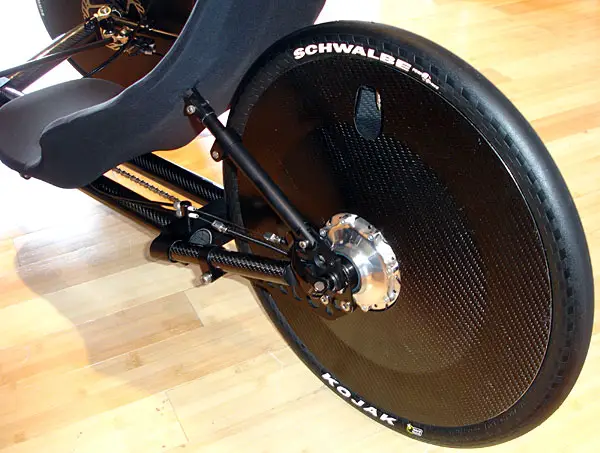

Ordered some tires, here's what they look like on a trike.
If the grip or ride is intolerable then I'll go up to BMX or Moped tires. These will secure my bike's identity to the police as a bicycle, and not a small bore street bike.
I figure if the grip is okay, they might be more efficient than fatter tires, there are a bunch of factors at play, but at least these tires won't be balloons on the mag wheels, which requires a lot of pressure to keep the sidewalls stable.
I hate messing with tubes and would rather deal with Slime's mess, so I'm going to to tubeless. It might have more grip that way, and the wheels will be lighter.

I used to run Stans No Tubes in my MTB years ago, but it was more mess inside the rim than what it was worth. Let me know if tubeless is now avail in high pressure tires (it wasn't back then).
-Low-
I'm not sure, it's quite possible it won't work at all. I figured that tubeless would allow for a bit more grip out of skinny tires at high pressure. I actually don't know much about running bike tires tubeless, but I thought that the mags would be a good wheel to try it with because there are no spoke holes to worry about sealing. I'll probably end up with tubes, going to research further whether it's safe to run tubeless road tires. I'll prolly end up with tubes, lol.
I was going to get Pirelli moped tires, but I think for the street these will allow me to get pulled over less, and on the track they should be more efficient.
I didn't realize I'd need to use sealing fluid too, I'm going to get some tubes. Thanks Lowracer!
I was thinking I might try to get a similar wider tire for the rear. Maybe Schwalbe makes a BMX tire...
edit:
Well they don't, lol. I looked around at BMX slicks with the goal of finding one with a regular size, sticky compound, no treadblocks on center, but some to keep from sliding out on bad pavement or wet. I want a fatter tire on the rear because I was thinking abut how my rear wheels always get out of round quicker than the front, some tire cushion is a good idea with these mags. It would be dreadful to have a wheel crumble at speed.
So this is the best I could find short of buying moped tires. ASM Animal tires sound like they're meant for ramps exclusively, so they're not durable.
I know Maxxis Hookworms are the norm, but I'm not fond of how they look, and want no tread on center and a super high pressure limit. This little motor needs low rolling resistance.
Chase Hawk 20 x 2.20, I can use regular BMX tubes in the rear. 100 psi max!
I ordered one tire, with the anticipation that I'll prolly go through two fronts for every one since fatter tires generally wear slower. I'm just going to use the tubes from my Motobike 2.25 knobbies full of Slime. I ordered some Kenda tubes for the front tires at a screaming deal of only $3 each!
