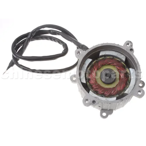

I've got an idea of how can make these motors hybrid electric for reasonably cheap, less than $200 and 20lbs. It would be a mild setup with small AGM batteries as an assist to the gas motor, of less than 500w or 10A max, it looks like the internal wiring can handle that.
You can get these starter motors, they're supposedly not so great, but anything can be improved. The biggest concerns I have are the brushes because as well as an electric starter, it would be used at a higher voltage to assist the crankshaft while running with a combination mechanical and electric throttle. Cooling is an issue with these under extended cranking, so maybe drilling holes for airflow around the outside will help, along with hanging it in the airflow. I've noticed that overvolting surprisingly makes motors run a lot cooler under load, because they don't stall out drawing tons of amps. Maybe 48v instead of 12v will work if everything is optimized. The brushes are the same carbon brushes you can buy at the hardware store in the slide out bins, so it'll be a service item.
This is also a magneto, so some current control circuitry could make the starter regen on decel even with a freewheel, although less so than with a fixed sprocket to drag the rpm's up. If the regen becomes a major element, then maybe a fixed rear sprocket would be in order.
This bike could fit 4 12v 5ah SLA batteries underneath the fairings along with the gas motor easily. The total weight of batts would be about 12lbs. and the starter and controller about 6 total. I wonder if its worth doing? It certainly is an interesting concept, and I think that assisting the crankshaft will make a two stroke rip hard because it will fill in the lower end of the power band. Linking two motors with a common solid crankshaft means that their horsepower and torque is added together, so it would theoretically be better than with a separate electric motor. For racing there's even lighter, cheaper, 2ah batteries that would weigh about half as much. I'm thinking if this worked smoothly it would just make the bike more well rounded as a ride for around town. The acceleration would be insane, with all the power going through a transmission.
Whattya think?
You know what? Nevermind! :P
1/2 hp after losses isn't worth the complexity, I could bump the compression a point and get that! It wouldn't be able to run only on electric because it would fight the compression, and then obviously start the motor. You could hypermile one of these motors with this method and a freewheel. Stop the motor and coast downhill and start the motor with a twist of the throttle to continue powered. It would require 24v to get the motor really zipping for a stop start system, but a small capacity 24v pack would weigh little.
But wait, a stop start system would seize a two stroke if it stopped really hot. Scratch that idea!
So in reality the little starter motor would need to be pushing 1000w to really make itself worthwhile. I have no idea what the current draw of one of these starters is at 12V, it would be doubled approximately, either that or the voltage could be doubled. The poor little windings would smoke with the first throttle pull I bet.
Nevermind!
