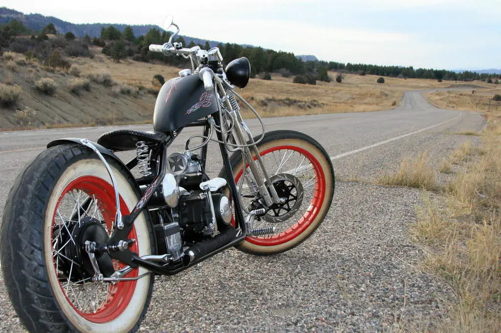

I had considered sticking one of those cub pedal motors in a Kikker Bobber. Should bolt right up.
