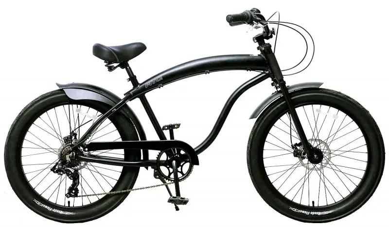

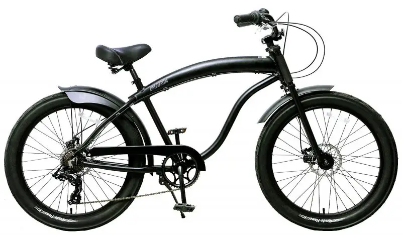

Fito Modena GT-2 works. 24" tires. Comes in 1,3, or 7-speeds.
24" wheels but a 26" ride with those 3" Kenda balloon tires.
The Fito is is no longer made or available anywhere, I have tried as they were a bargain at ~$350 to propagate, and Don and I talked about a Grubee GT gas tank frame with a rear disc brake mounts he did it it, and it was was great!
It made for some cool bikes ;-}
Hope that help a least a little.
