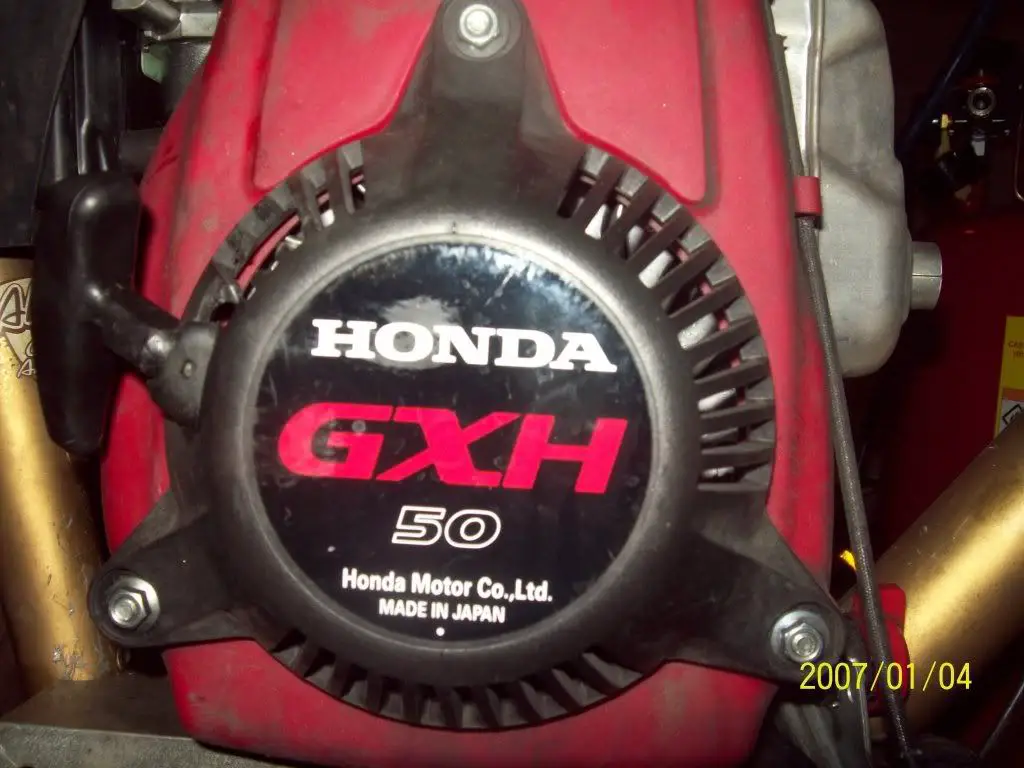

I don't mean to be a buzz kill but ain't Honda motors prolly manufacturers in china? (I realize that Honda is a japanese company and build the most reliable motorcycles of old, but even Harley parts are made in china now!)
I have a GX50, says "Made in Japan" on it. Tried to look it up, Honda has many Assembly plants listed for cars, but not finding small engines. One bloger said they are made in the U.S. and Japan. I am not finding any confirmation though
A lot of places have parts made there. China, or as we say at work- "Offshore".
Where I work, we make parts for Harley, and we also make parts for Volvo, and several other truck companies, not to mention school bus body manufacturers.
We ALSO get some of our parts from China and Taiwan. I am not allowed to say what parts go where that came from here or there, but they all end up somewhere. If speced out right, and quality control is used, you can't tell the difference in where anything is made.

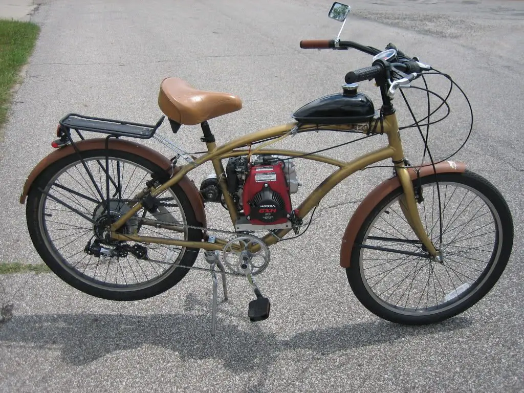

but this looks like it belongs there
i was the first to purchase firebelly's universal in frame mount so i sent Evan my specs to make sure it would work
i have to remove the spark plug just to get the engine in
tell me that doesnt look like it belongs there
it couldnt have worked out better if we tried
i LOVE it
That is BEAUTIFUL Jared! I'm a little biased. I have a new gold Calypso in a non-motorized (virgin?) state, and I'd dig hearing how you made the 4 stroke conversion. Do you have a blog or any basic advice you could give? I'd really appreciate it.
Well done you!

where would the sticker on my honda be that says where it is made?
there are gearboxes for the 4 strokes with no clutch lever whatever to mess with
Got websites or names???
I would think it would say it on the red plastic cover on the right side of the engine. Have never looked on mine since it's an HS...it's from China without question.
