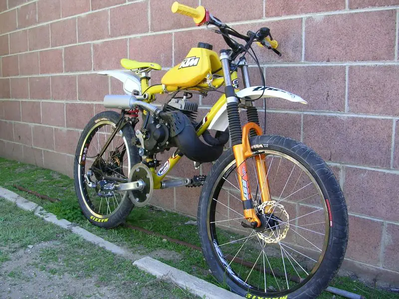

2nd Build Full Suspension KTM Clone, SBP Shift Kit

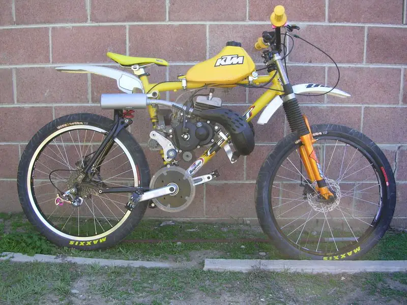

I haven't been here in a while but yes it was finished a very long time ago. Im about to post an update.

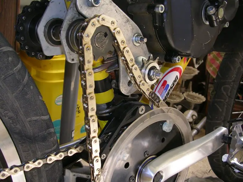

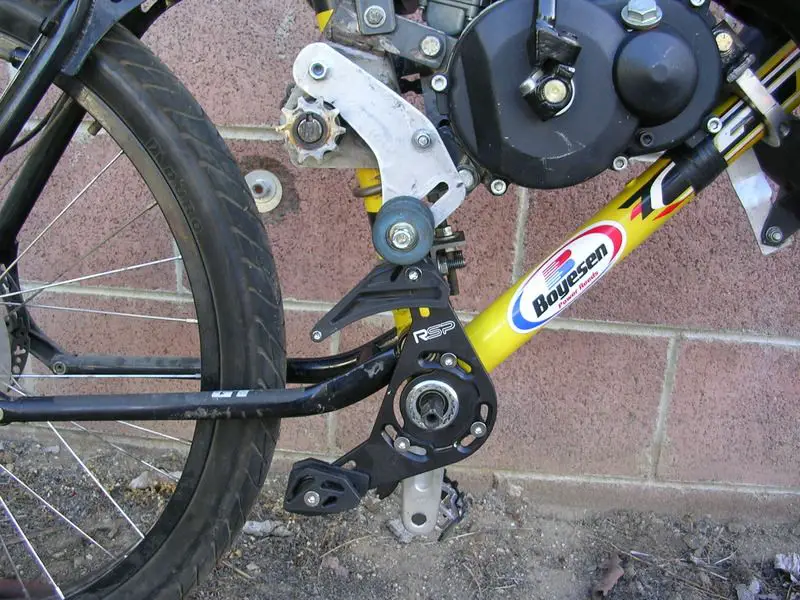

I haven't been here in a while but heres an update. The bike has been raced several times now and has been pretty reliable. It did have a chain stretch problem on the secondary drive chain (The one from jackshaft to pedal arms) but I have found a much heavier 410 chain that doesn't stretch made by wippermann.
I also added a downhill mountain bike front chain guide since that chain had jumped of a couple times cause the jump stop that comes in the SBP kit doesn't work that well. I had a front derailleur in place of the jump stop but even that let the chain jump off a couple times. No more chain problems since those mods and the bike is great!!!
