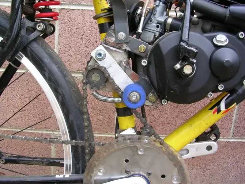

Doug, I bought a spare clutch since the shoulder bolts threads were messed up on the original and I wanted to have a spare in case it strips later on and on the spare clutch I used the spring washers that I showed in the earlier post and I use the thin shims to adjust it so I dont have any free play in the shoe when bolted up and yet very little to no preload on the spring washers. The coil springs have preload and I suspect that they will have a higher rpm lockup that we dont want but if you try the coil springs please let me know if they start to grab right off idle because thats what we want. Those coil springs may work great but I suspect they will lockup a little higher than we want.
Also you have to pick up the rear tire and see if the clutch is dragging at idle, that we dont want. My bike when the engine is cold drags just barely so after I start it when its cold I hold up the rear tire a few seconds and blip the throttle a couple times and then its fine and doesnt drag at all.
Oh ya the second clutch had a different stack than the first so they arent consistent from the factory I guess.
