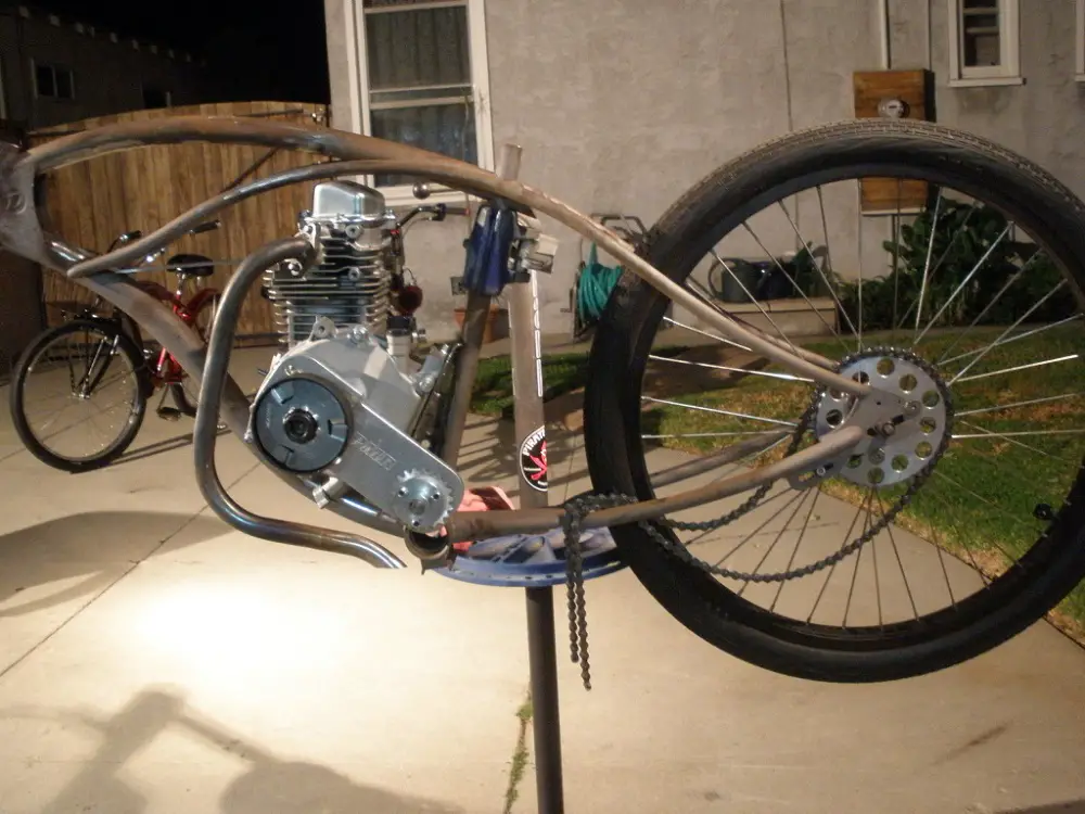

So here it is so far. still working on the engine mounts,but its coming along
  • Like
Reactions: EZL
Man, that motor fits nice. This is going to be an awesome build! What's with the chain ring on the left side?
That's all the chicken with the gravy! Flat out awesome Glennbo! I haven't had a problem but are you thinking of beefing up rear dropouts at adjuster screws? No problems with a china girl but it looks like you could dig a trench with that mongo! What do you think it weighs?
It's really an incredible accomplishment you got that mass in there after seeing your first picture. Congratulations! really, really nice!
